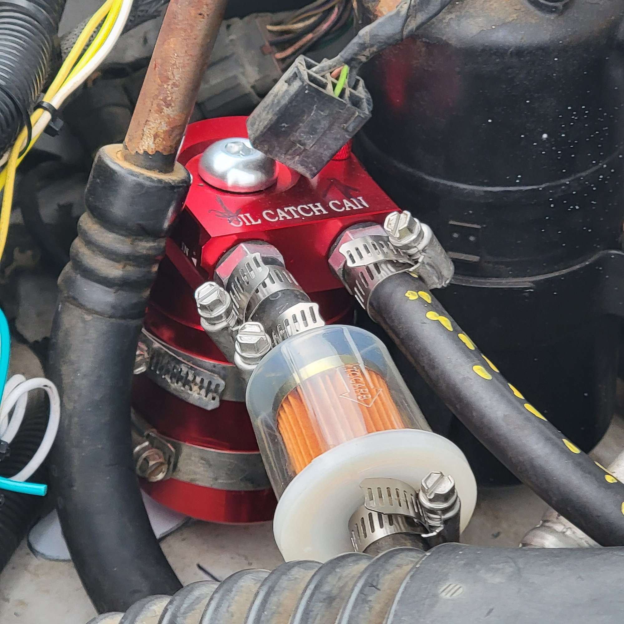

Fuel filter is to find out if the can is separating the oil out. Probably didnt need the hose clamps, the barbs are really tite
Fuel filter is to find out if the can is separating the oil out. Probably didn't need the hose clamps, the barbs are really tite

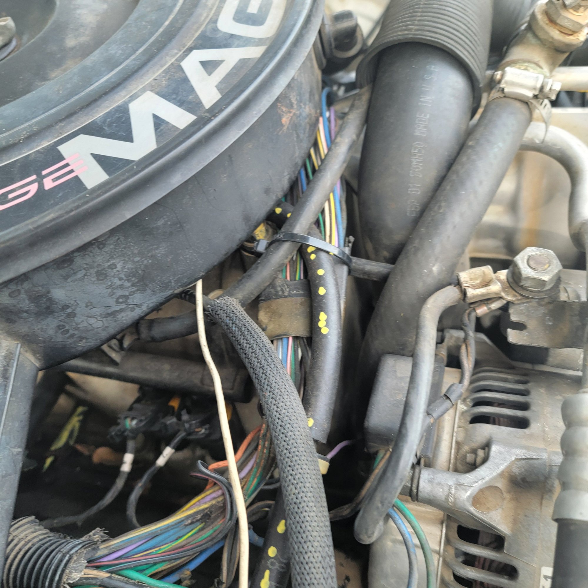

UnSqueeshed wire bundle.

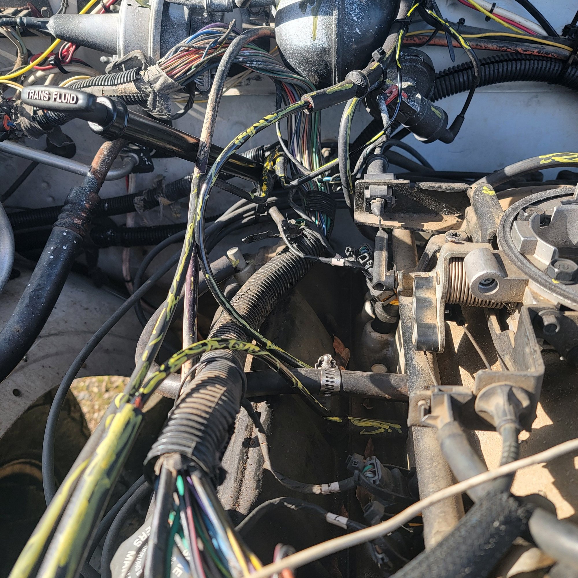

Yellow rats nest, should mark vacuum lines, except for the fuel crossover at rear of keg. And the wire bundle on top of passenger side valve cover.

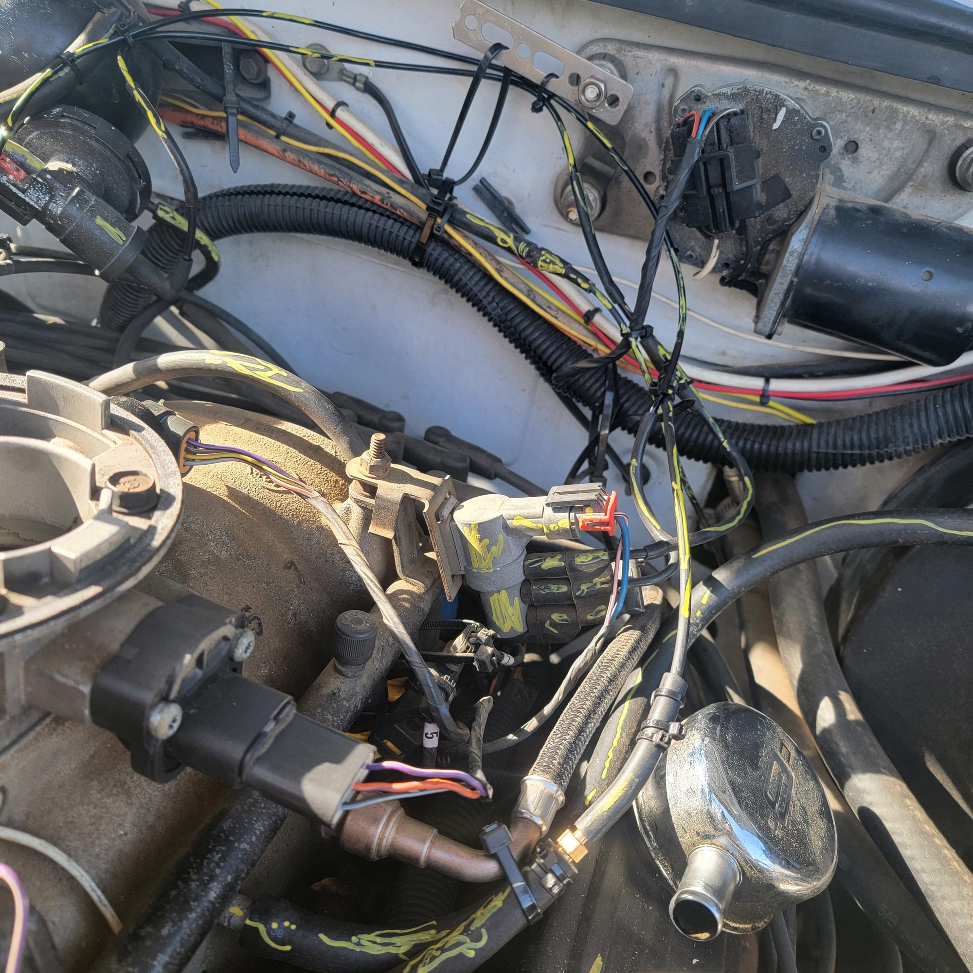

Showing in fore ground, 1/4in X 1/8in barbed adapter and vacuum hose to hard line. Yellow on purge solenoid, to hard vacuum lines moved to firewall. Maybe I can fab a shelf either under the convolted wire bundle or above it, to hold the EGR and the purge solenoid.

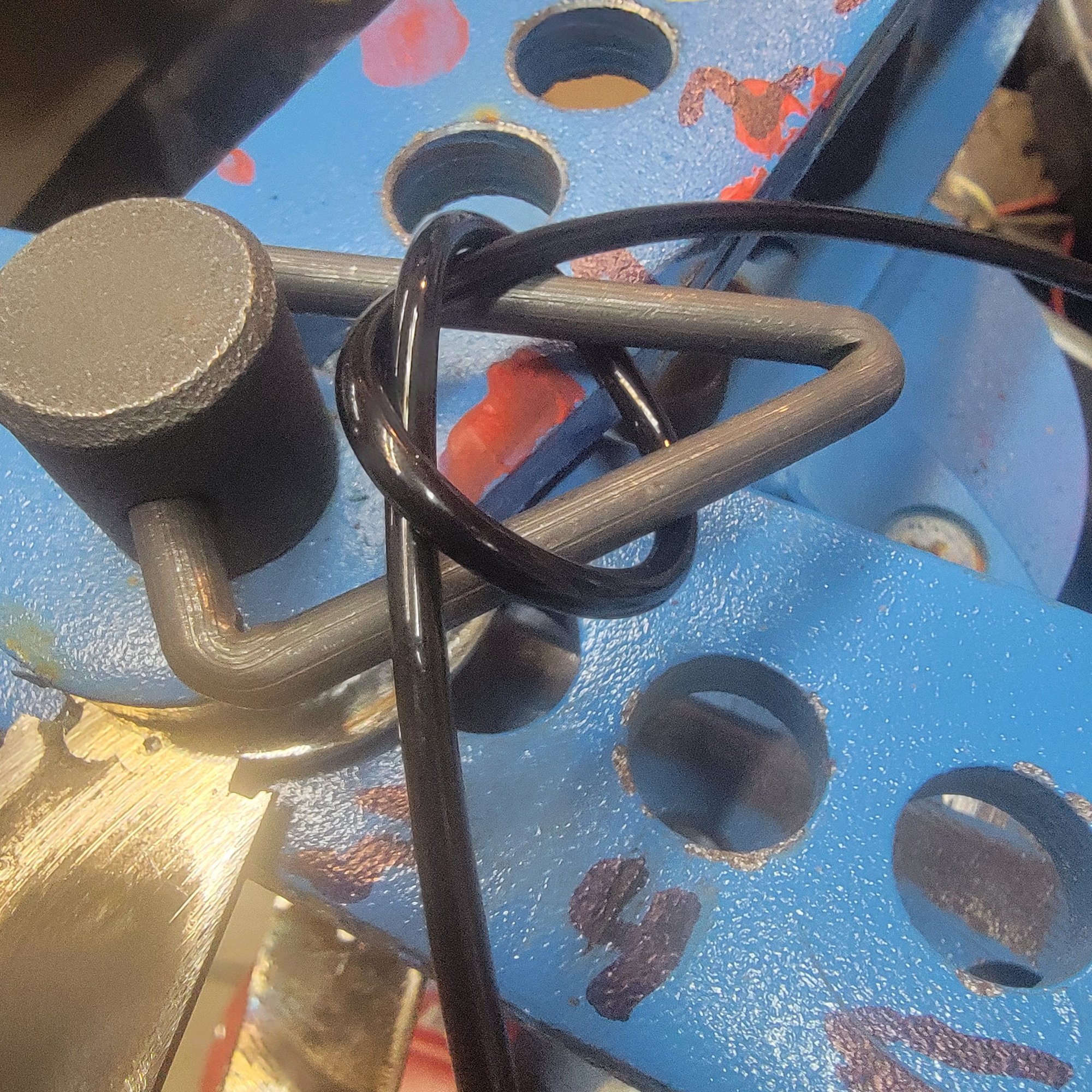

Really limber vacuum hard line. The knot is about 1in in diameter.
