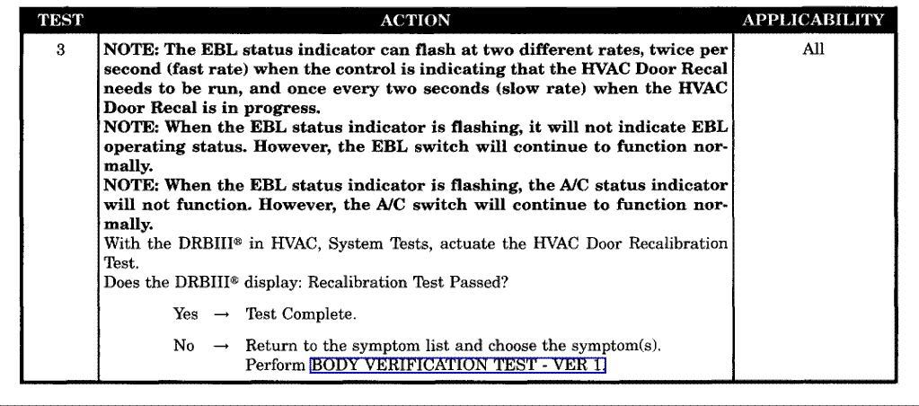

The blinking on the rear defrost light is on purpose telling you indeed as suggested in the first post that the HVAC Door Recalibration program needs to be ran.
Now that you know the problem, go to the dealer and tell them specifically what you want done. Saves you time & money without them scratching thier heads lost and aimlessly trying to solve your problem. You know exactly what is going on now and can tell them what to fix.
HTH!
