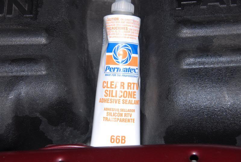

When your done, put a very small piece of electrical tape over the hole and then cover the tape with silicon to keep the tape in place and to keep dirt out. I dont suggest filling the hole with silicon as if you need to access the hole again, you may push some that is in the hole into the sensor which could cause problems.

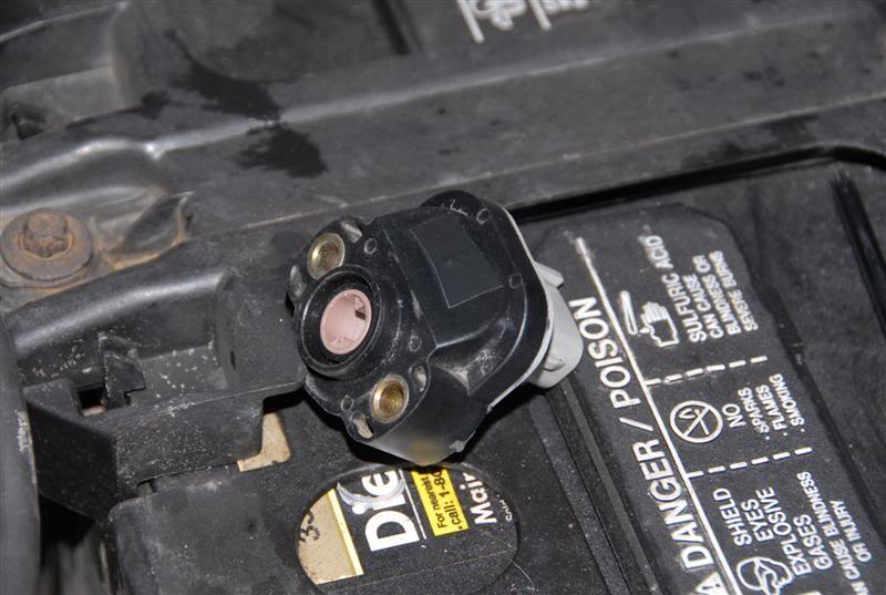

1. Remove TPS sensor from Throttle body. the 4.7's take a T20 torx bit/driver to remove the screws.

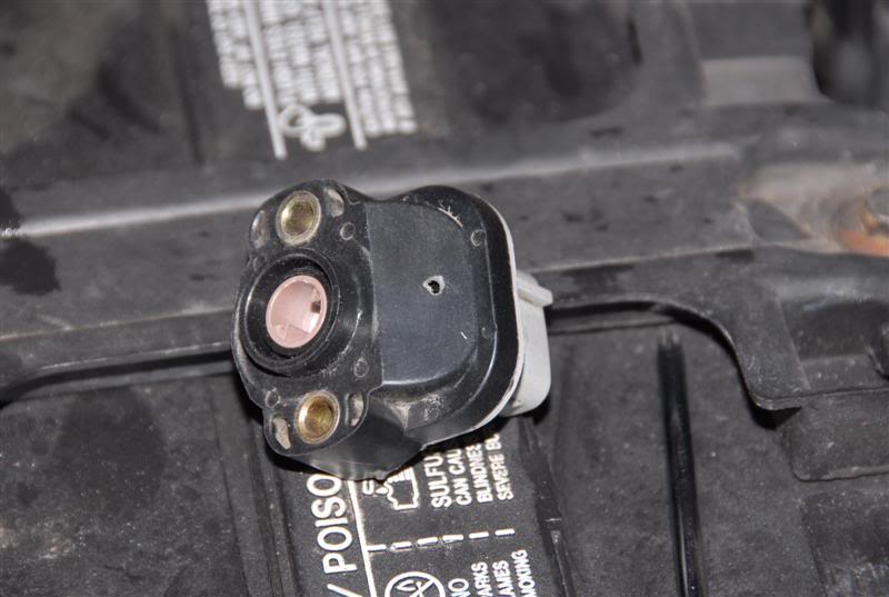

2. Drill a 1/8" hole in a spot where you will be able to spray in CRC Electronic Component Cleaner and the drill bit will not go in too deep too fast.
in other words... drill with a very light hand so you dont damage the contents of the sensor.
3. Spray the cleaner into the hole, dont be shy with it...
4. Rotate the sensor shaft so that the cleaner will get into the contact area's of the sensor.
5. Shake out the excess solvent until all of it is out.
6. Once your convinced it is dry, cover the hole with a very small piece of electrical tape and seal with silicon sealant. I used clear so I can see the tape when it dries, probably wont be necessary to have clear. If you dont use tape, you could get sealant into the TPS and that may cause problems that you cant fix w/o buying a new one.

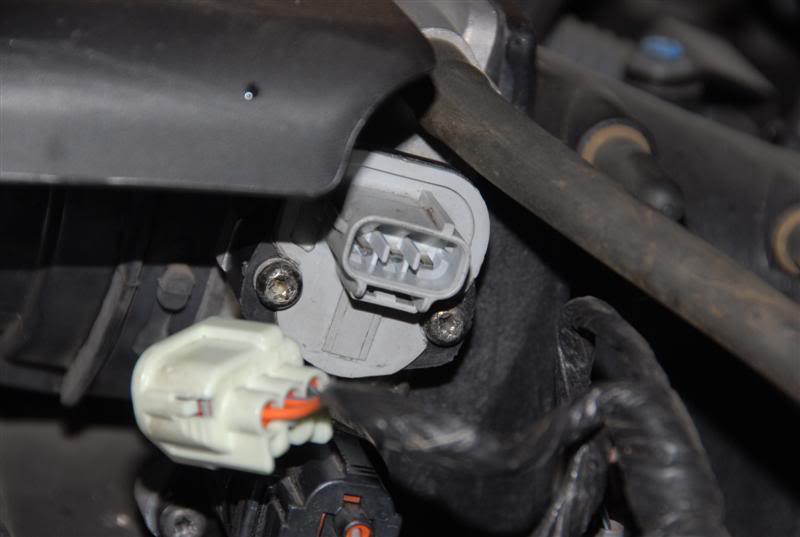

7. reinstall sensor into the TB.
8. Reconnect the sensor electrical connector and your done.
