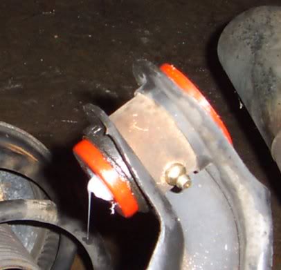

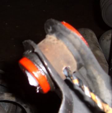

if you get poly bushings make sure to install grease fittings so you can lube them at every oilchange - poly are prone to squeeking and if they are run dry they can wear out extremely fast. its a good idea to do this on sway bar bushings as well as swing arm bushings.
(not part of a durango but you get the idea)
larger hole just through the metal sleeve - sized to allow the grease fitting to thread into the sleeve.
smaller 1/8" hole drilled through the bushing.
grease fitting screwed into place.
