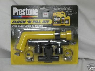

Okay, flushing the system.
2 ways I suggest doing this. well really 3 ways.
1st, buy a cheap replacement radiator and flush the system before installing (can get cheap radiator for around $150-180 if you look around.
2nd pull the radiator out and take it to a radiator shop and have them profesionally clean it out, then flush the system before installing it (another words flush before pulling it out, then pull it have it professionally cleaned.
3rd Just flush the system
When I say flush this is about the best home method
Buy this
Buy this (make sure it is the super flush and not the super "cleaner"
Follow instructions, garden hose is needed
One thing you need to take into consideration is that if you system is having a hard time colling, even though its "not overheating" it is still running warm.. with that said so is your transmission, YOU DO NOT want that to happen with these transmissions. they will not last long under such conditions.
