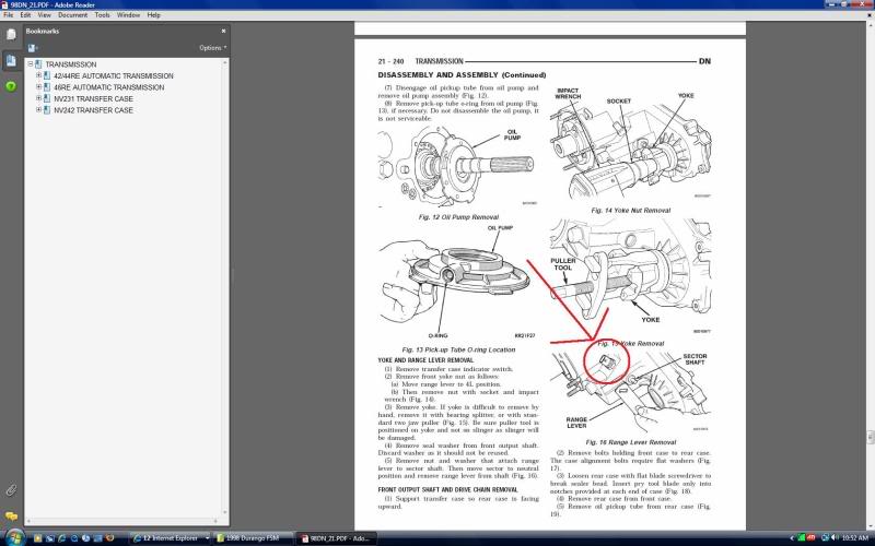

Old Jul 4, 2009 | 12:57 PM
hydrashocker's Avatar
hydrashocker
Joined: Jun 2005
Posts: 14,228
Likes: 19
From: Riverton, UT
On the trasfer case by the selector shaft. It's not hard to find.
Old Jul 16, 2009 | 07:33 AM
durangoSLTV8's Avatar
durangoSLTV8
Joined: Jul 2009
Posts: 34
Found it! Now my question is when I pull that sensor, will a bunch of fluid run out?
Old Jul 16, 2009 | 03:20 PM
durangoSLTV8
Joined: Jul 2009
Posts: 34
ok, so I found the wrong sensor. I new it was too easy that the sensor would be on the bottom of the case...of course it's on top! do I have to drop the case to change this sensor or does anyone know any tricks???
Thanks
Old Jul 17, 2009 | 02:08 PM
hydrashocker
Joined: Jun 2005
Posts: 14,228
Likes: 19
From: Riverton, UT
You might need to pull the block out and drop it down far enough to get to it. With a skinny arm and a mirror. Never done it before myself, (paid for it) but it shouldn't be that hard if you start with a couple of shots of wiskey.......LOL
It looks like it's on top so fluid loss shouldn't be much if any. It works by linkage not fluid.
