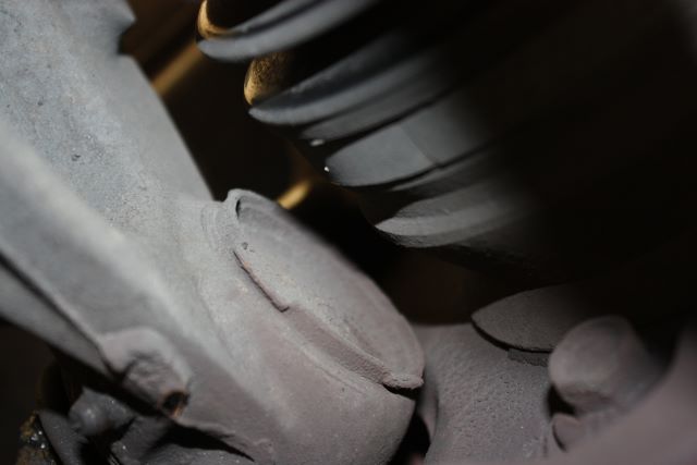

One more question, my ball joints look to have three or four ears that appear to bent outward instead of the retaining ring. Do you have to grind the ears away or will they fold back on themselves when you press the BJ out?

Must be something like grease. Take a picture please?

i hope this works....

Not sure I have enough room to clear the axle if I just pop the lower BJ loose. Thoughts?

Well if your able to pop that lower one and get it all the way of the flange bolt on the ball joint, then ya u will because all you would do then is just push that hun out of your way moving the axle with it. thats if u can get it to clear the ball joint.
