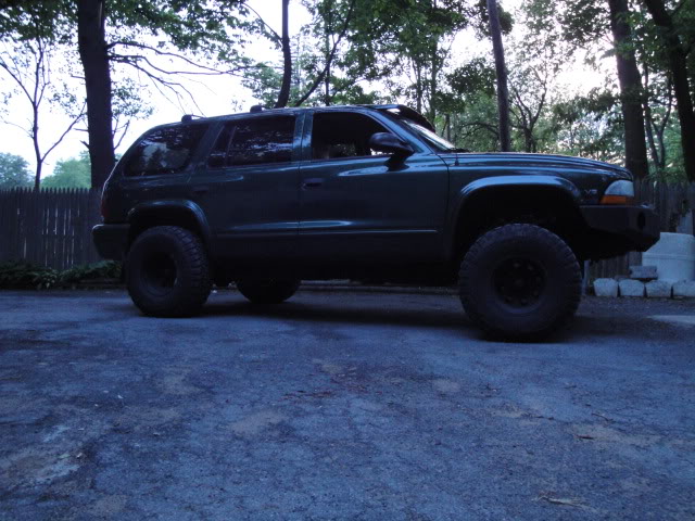

What ya think about the rear stance? I'd thought it'd be cool to go the reverse muscle car style with the front popped up and the rear squatting. (No extra weight in the rear)
If all the spaces didnt give it away already
I'd think the same as you did when you first saw it, if it wasnt really because of this.
Its a real bummer with all the stuff i have on my plate, time to put her down....
Cool thing though, now i can see what close to stock looks like vrs lifted.

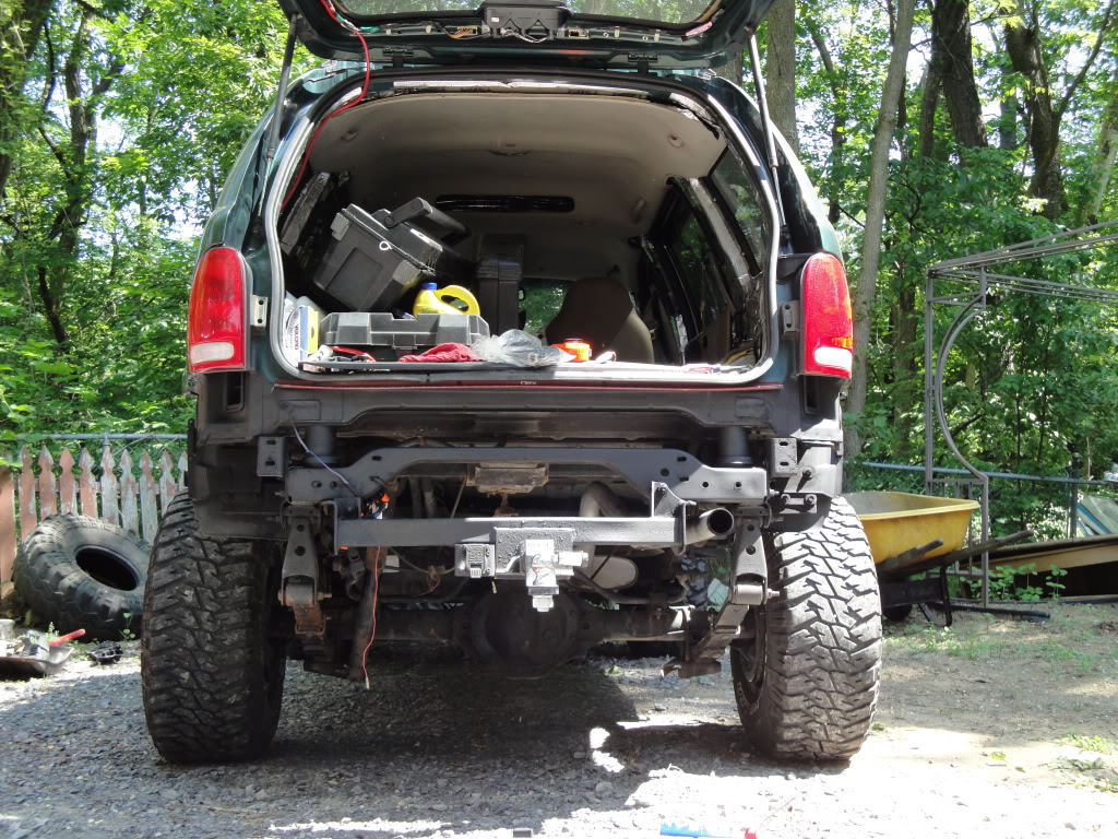

Duranged gets revived..
Test drive went good and she's road ready, but i will wait. need shorter (stock) shackles so it doesnt look like im rolling on donuts and some shocks to take the bounce out.

So you bought larger springs it look like!
Nah, just used the ones for my lift. Really didnt want to spend $185. for each pack so i just used the ones i have set for the rear dana 60. If i had my tires and wheels i would of kept it up on cribbing and put the front together

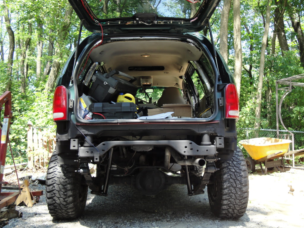

Update**
Finally got a new set of shacks, $68 a pop. Tossed em in with new shocks so now she sits purty and rides like a dream. Next step, shims to correct the pinion. 3/4" higher than fronts but when dressed should return to normal with 2x the artic.
Be careful if using wedge shims. They like to slip on people.
