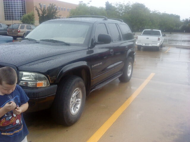

I'll attempt to upload some pics of the new Durango in our family.
New member/Dodge owner/Intro- and some problems-37857_146297775381644_100000042682061_425535_4423424_n.jpg
New member/Dodge owner/Intro- and some problems-imagejpeg_2_4.jpg
New member/Dodge owner/Intro- and some problems-imagejpeg_3.jpg
Not my kid in that last one, the last two were the pics previous owner sent us. Our kids only a year and a half, but he thinks this thing is his. lmao.

Ok one more edit, the POS silver mitsubishi next to it is not ours lol.
