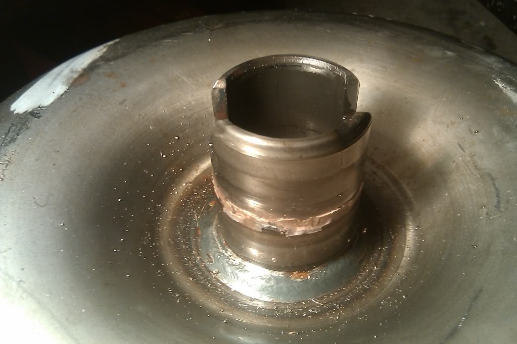

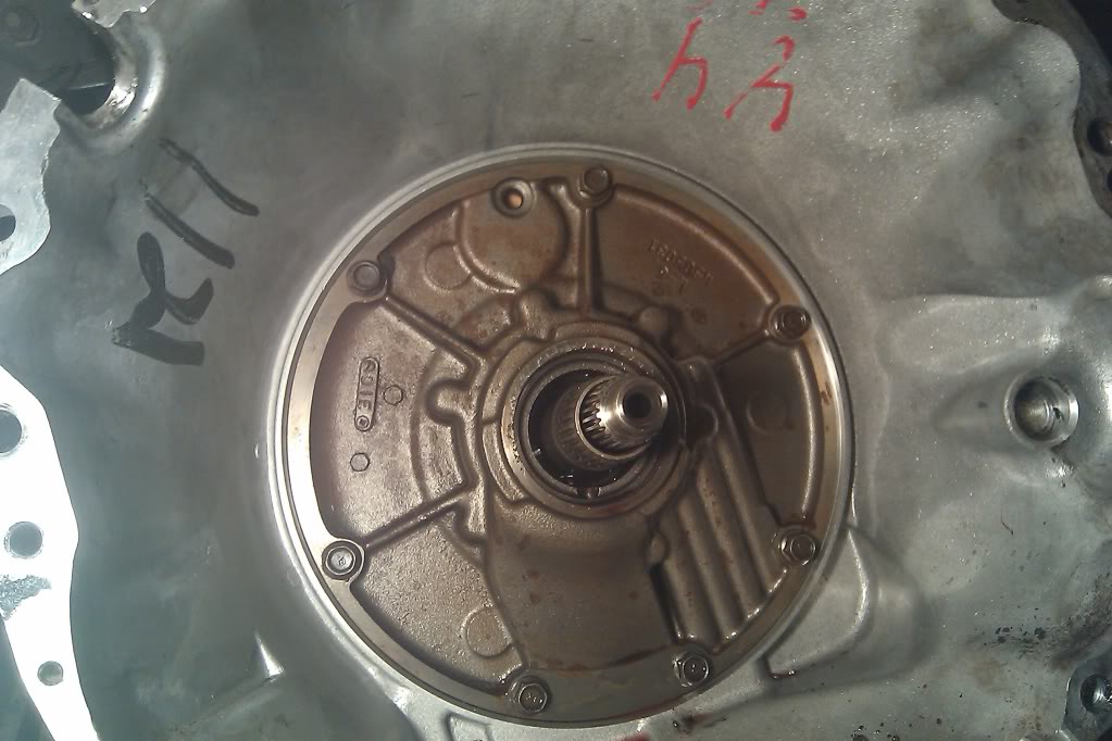

Pulled trans to fix front seal leak on the 98 D in sig. TC was "stuck" had to gently pry it out with tire irons on either side, Im not a transmission guy, but I belive the front pump bushing is/was siezed to the TC snout. I didnt realize thats what it was until looking at some rebuild pictures, then it hit me. SO... Now what? Can I just pull the pump and put a new bushing in? Or am I looking at more internal damage? Truck drove just fine as long as you kept enough fluid in it. Had high revs when first started when cold to get it moving, but only a few seconds then took off like normal after that. Do I need a new TC as well or more internals?
I split the bushing off the TC snout, some of the material stuck to it though, I will try to post some pictures, Can it been cleaned up (if the TC is still good) and reused? Need this thing back on the road now....
I know, I need a seal puller, kinda knicked that surface up.....

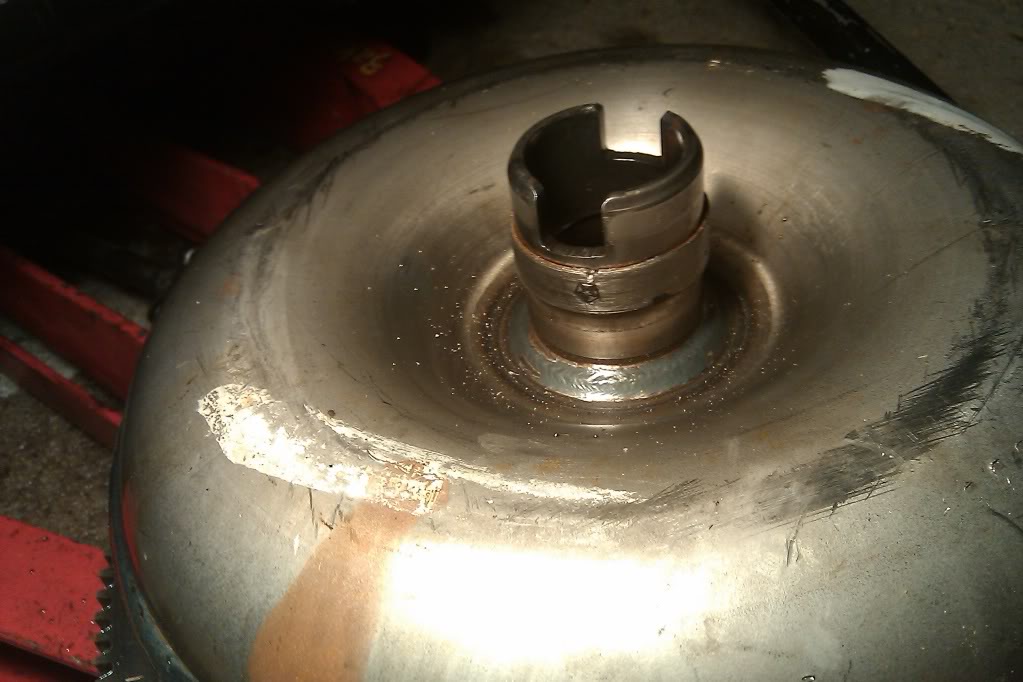

All those specs are stuck on there, is that just crap that didnt get cleaned off from the welding process or what?

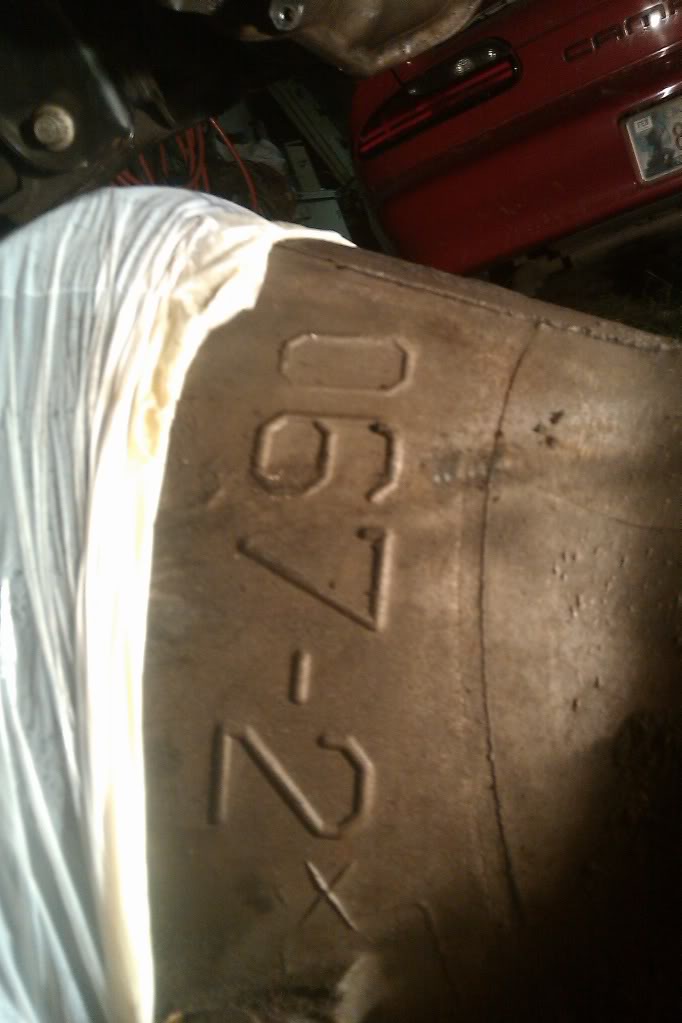

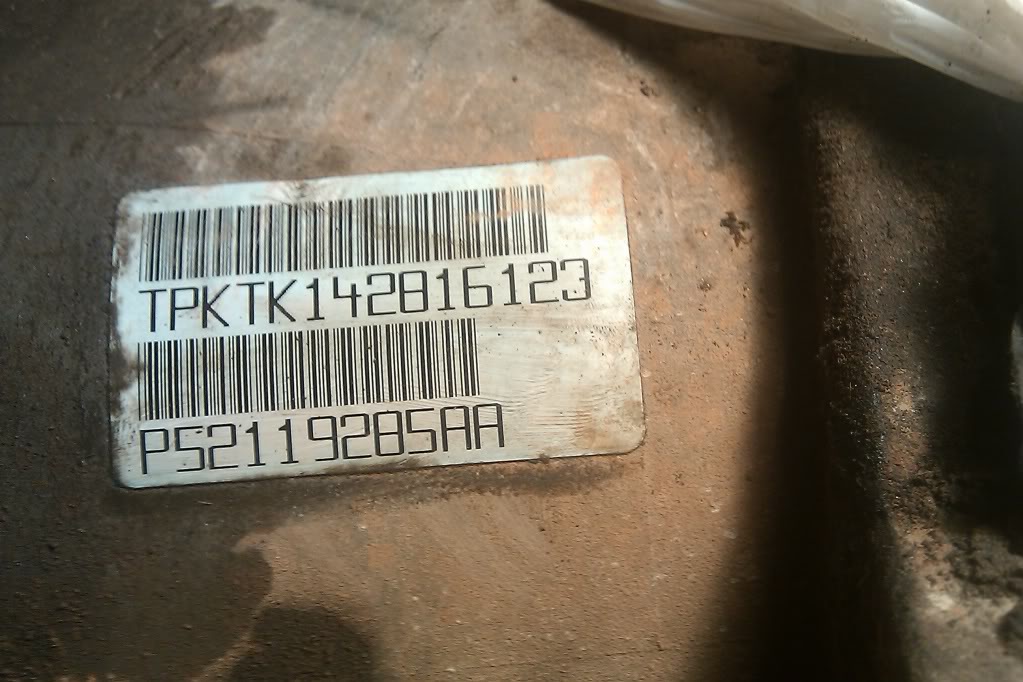

This is a 46RE with lockup right? and the scratches around the outside of the TC I think were from me sitting there spinning it and rocking it around trying to get it to come out, it wasnt making any noise when running, and if pushed it all the way back it spun freely in the pump.... Do I need a new pump too, seen a post mentioning not to reuse a pump that had spun the bushing.
What are those specs? Did you try scraping it off?

The specs were left over crap from a bad reman weld job. I ended up taking the trans to a local Aamco in Tulsa, They had a used pump in good shape sittin on the shelf. They rebuilt/resealed their pump and installed it in my trans for a grand total of $50. I love bein a car nut sometimes, sit there an BS with the manager and get a good deal. They couldnt do anything with the TC and their lowest was $300. I didnt have that, needed the truck back together. So I started callin around and Oklahoma transmission supply had one for $160 after tax. Very good quality, welds looked pretty much flawless, much better initial quality than what came out of it. Got the truck all back together couple days ago. Drives great, no leaks.
