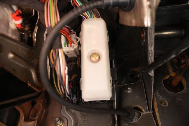

Old Aug 17, 2010 | 12:33 PM
samelewis's Avatar
samelewis
Joined: Aug 2010
Posts: 15
From: Cottage Grove, MN
Need some help please. Durango will not start after putting dash back in.-img_0237a.jpg
This is the culprit as to why the Durango wouldn't start. When my brother and I put the dash back in, we decided not to tighten everything back down, just in case we had to take the dash back out. Well, my brother was able to seat the connector, but didn't tighten the bolt. So the connector really wasn't making contact. Once we figured this out, everything worked great.
Scott.
