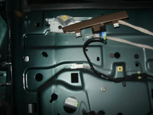

I have a 2001 Durango and my right rear window stopped going up. It will go down (it's all the way down now) but not up. The lights on the switches all work and I can hear the motor engage when I try to make it go down. I reseated the connectors on the drivers (main switch) and reseated the rear passenger side as well. I banged on the area where the motor (I believe) is mounted. Still not going up.. I noticed someone stated that I should unmount the motor and blow it out or something like that. Any Ideas.. It's cold as hell when the windows down in ther winter.. I have attached a couple pics of my rear window for you to reference when answering my question. How do I fix this?

replace the motor!! you can get one at the auto parts store for under $50

seeing as how the motor will go down but not up i would open up the door panel and make sure nothing is jamming the window or window track and that the cable is routed properly (it should be pretty obvious if its off its track)

Is there a way to test the motor to see if it is good or not? The window rolled down fine and I can still hear the motor trying to roll it down but just no noise when trying to roll it up.
