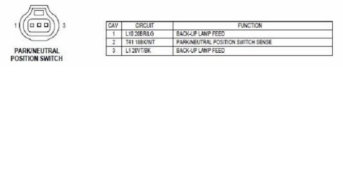

The Neutral/park safety switch for a 1998 has 3 wires on it. It has a clip on top and the pin outs are straight across.
You should be able to find a harness of a RAM, DAK, or DUR of about 1997-1999 model years if applicable.
yes i know. the one the\at the dealer insisted i need was the transmission speed sensor or some crap like that and that only has 2 wires and 2 connectors
