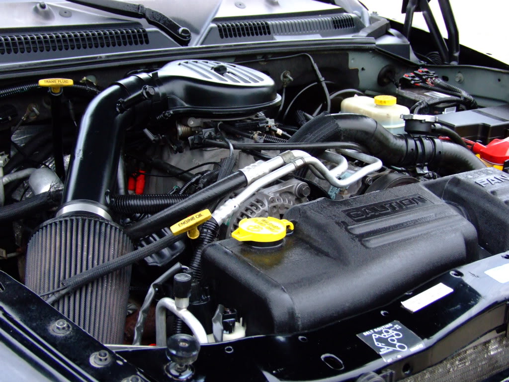

I did this last night...
Spectra Air Filter and parts from Lowe's plumbing... $40.00 I then pulled the cover from beside the radiator to get more cool air in, and still plan on a baffle or something to keep hot air away from the filter.
I'm lovin' the pvc piping!

The challenge I had was that the 3"/3" Fern-co is designed for the OD of 3" PVC. The inlet on the stock air hat is 3", so the thickness of PVC was the amount that the Fern-co was oversize. I used the 3" to 3 1/2" adapter that came with the Spectra on the air hat then stretched the Fern-co around that, then an 8" section of 3" PVC slid all the way into the fern-co then the two 45's with only enough pipe to get them to but together, and the 4" size of the Spectra clamps right around the OD of the end of the second 45. I'm happy with how it turned out white PVC and all!!!

I did notice the throttle response was a little better, and it seemed to sound cooler. I installed it then hitch'd up and went camping for the first time with the D... uphill into the wind the whole way, 7.5 mpg... at 70 mph.
I got better mileage with the wind going downhill... But not much! I think that I may make a wind deflector to get the air over the camper instead of into the front of it...
