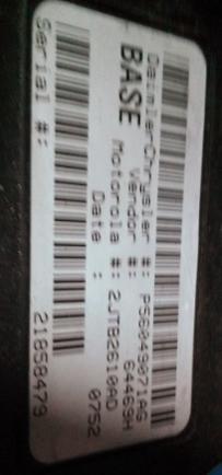

Thanks for the good info but how did fix your #10:
"10. Checking the electrical problem with battery drain - $1200. Changed CTM which was not the problem."
I've traced my drain (~500mA) to my CTM (pulling fuses). I'm hoping that there is just a short in one of the accessories it feeds and not the CTM itself. The only electrical issues I have other than the drain are flickering dome lights, and that might just be from the low battery. I have an '02 Dakota 4.7L 4x4 Sport Ed. so no power anything, no aftermarket electrical accessories, and not much to go wrong... Does anyone have a wiring diagram for a damien-chrysler CTM? (model and serial # attached in picture)
I'm pretty sure my issue is in the "upper" (largest) of the the three wiring bundles which seems to control the "front of vehicle" accessories, because when I unplug it the drain stops (unfortunately I also loose my headlights & such). The drain also stops when I pull the "bottom" (white) bundle but I think that's just because it contains the power to the CTM.
My short term solution has been to unplug the battery after each trip and I have noticed that there is a slightly audible "clicking sound" near the battery tray, which does go away when I pull the fuses to the CTM & kill the drain. Battery tests fine at autozone, and is new but has also been drained pretty low (twice now). Oddly this clicking (and corresponding drain) is periodic and never happens in the morning when the vehicle is cold, but always happens in the afternoon when it is warmer out. I'm pretty sure it's the sound of electrical discharge but I don't see any sparking in the dark and I can't tell exactly where it's coming from.
Any advise would be appreciated,
Thanks,
Keith

the clicking could be a sticky relay attempting to engage, i would see if there are any relays int he PDC that are clicking (its right next to the batter)

It does kinda sound like a relay going spastic, but when I pulled my fuses I pulled each relay in the PDC individually and it didn't stop the drain...

Obviously there are several things that causes the battery drian. Glove box light, wiper motor, cluster etc. The clicking from the CTM is only a symptom and NOT the cause. So don't go changing the CTM. Waste of money.

remember the clicking sound from the CTM is NOT an indication that the CTM is bad. It is just that a relay is spazing out because of lack of power...ie dead battery.
