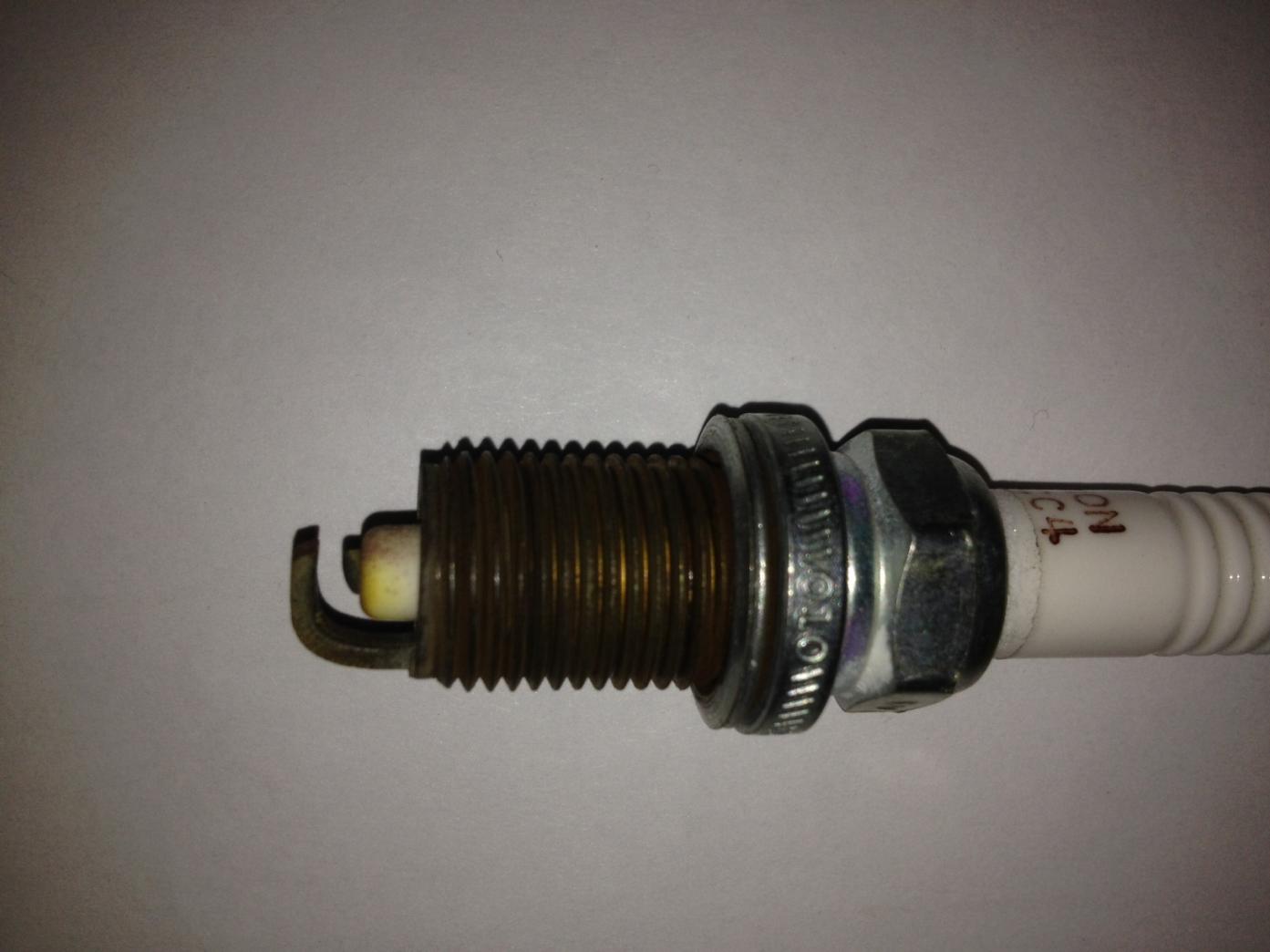

The truck started after it cooled down and pulled code 0344 when it stalled. Any thoughts ? It seems to stall when the motor heats up. I also just pulled the plugs. Do you think these may be the problem?

the plugs definitely need to be replaced, also it would help to know which engine we are working on, 4.7 or 5.9???
