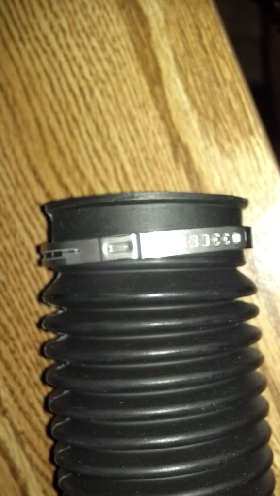

The passenger side bellows is torn on my rack and pinion. I bought a new one and am going to replace the torn one tomorrow. My only question is that I am not familiar with the type of clamp that is used on the bellows(pic below). Do I need a special tool to tighten it down once I have the bellows in place or can I just do it by hand?

I think you can use a par of channel lock pliers.
They do make special pliers for the job.
http://www2.otctools.com/otctools.co...44AutoSpec.pdf

yeah those require a special crimper. I would personally save yourself the headache of trying to get channel locks or a pair of dikes on it to crimp and just get rid of that clamp and just use a worm gear clamp. You could also use a heavy duty zip tie just make sure it is really tight.

Thanks for the replies guys. Ill give the channel lock method a try first and if that doesnt work Ill go the zip tie route.

Use dikes. It will grip it almost the same as that crimper.
