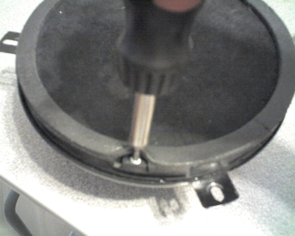

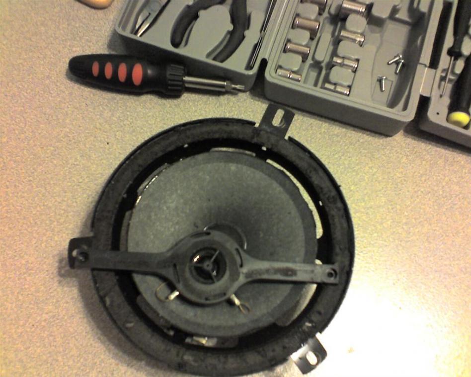

1st pic - Shows you the Rear speaker
2nd pic - Use a flat screwdriver to slowly pryoff the plastic trim

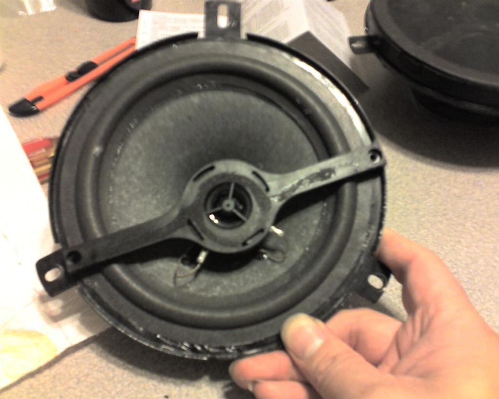

3rd pic - carefully peel back the insulation and use a torx driver to remove screw on each end to remove the tweeter assembly from the plastic trim ring. Tweeter assembly cannot be removed from speaker so be VERY CAREFUL not to break the wiring connection to the cone.

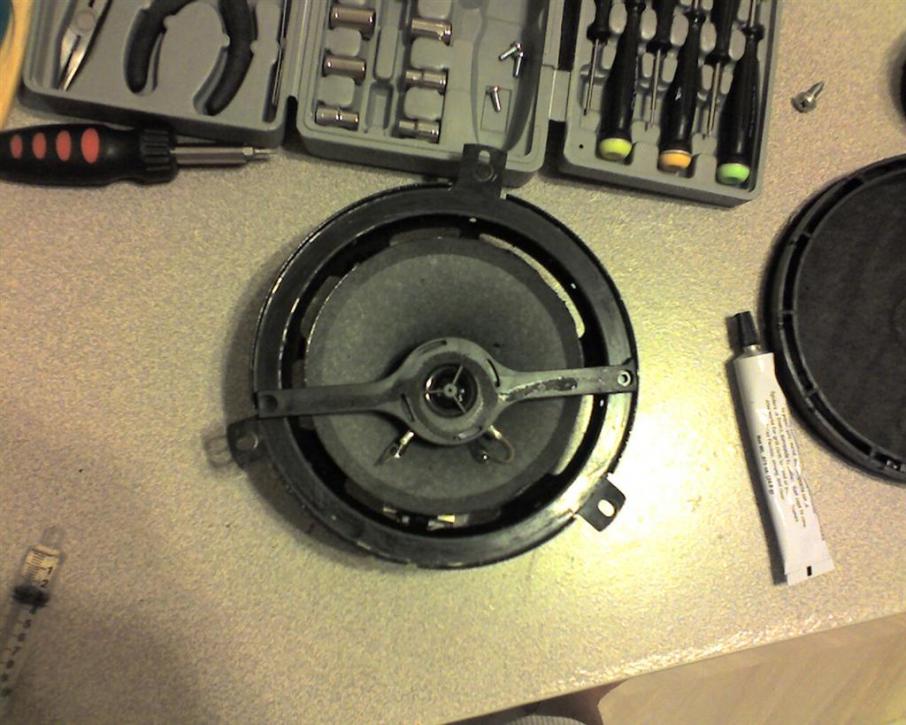

4th pic - Shows the original surround foam completely ripped and tweeter assembly loosely connected to speaker cone.

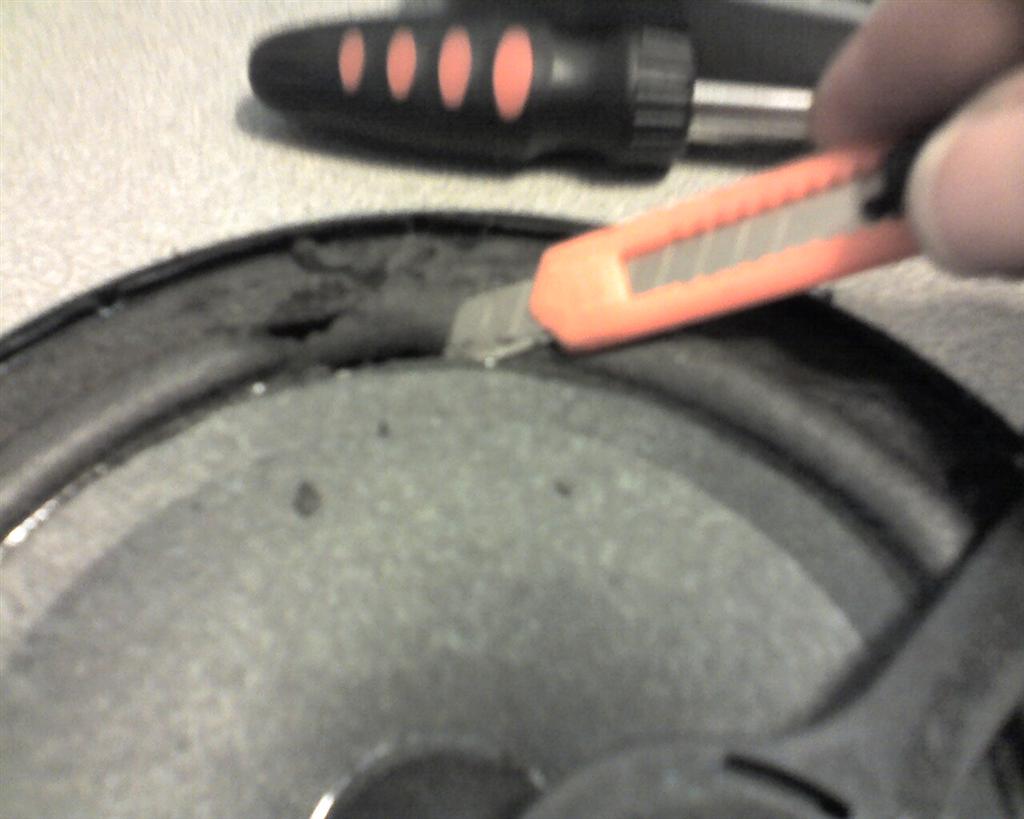

5th pic - Use a exacto knife or very sharp razor to trim off the broken foam

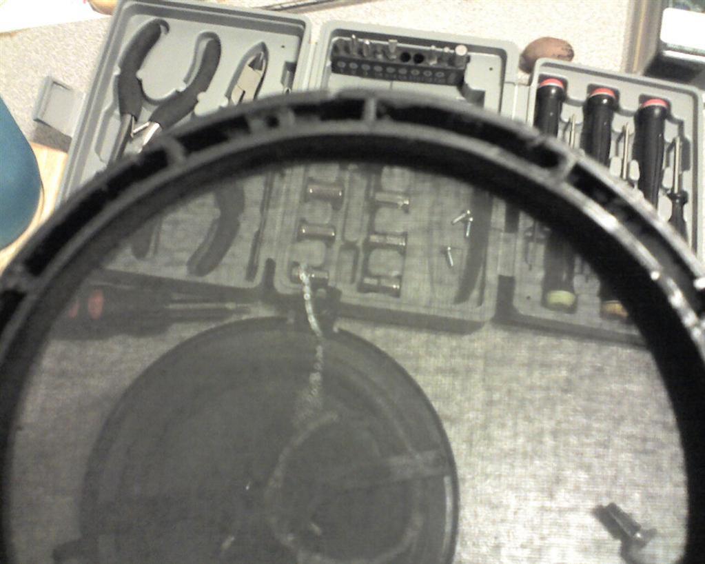

1st & 2nd pic - Speaker cleaned up by removing all the foam on the metal ring and trimmed off bad foam from the cone. Use rubbing alcohol or fingernail polisher remover to soften and wipe off the factory adhesive glue.
3rd pic - The trim ring. You will need to use the exacto knife to clean off the foam and adhesive. Again you can use rubbing alcohol or fingernail polish remover to make removal easier.
4th pic - trim ring all cleaned up.

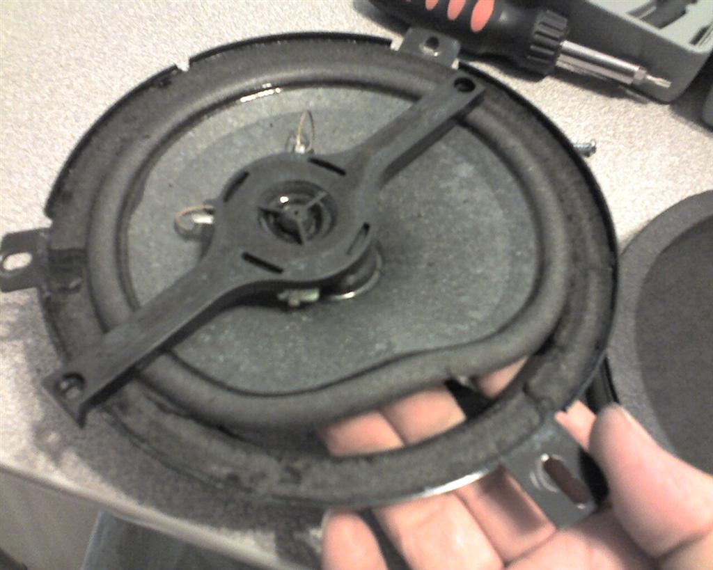

5th pic - Install the replacement foam. Follow the easy instructions. It says to glue the inner foam to the cone first, let it dry for an hour, then glue to the outter foam to the metal ring. Let dry for another hour

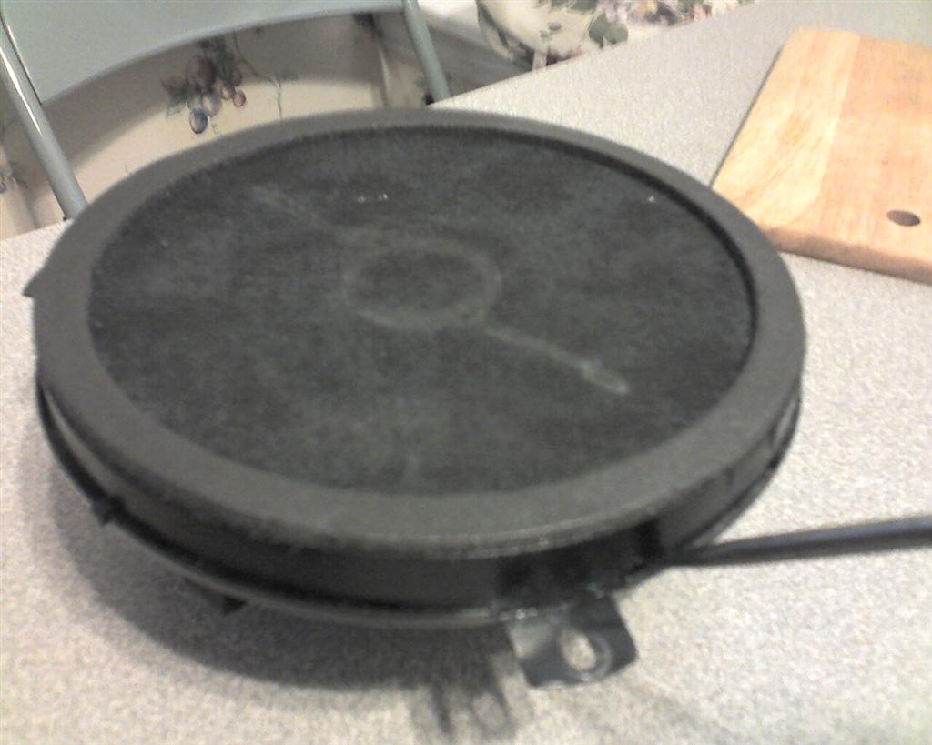

1st pic - carefully remount the tweeter assembly back on trim ring. Screw the 2 torx screws back in place to hold the tweeter assembly. Careful not to tear the foam trim. Then glue the plastic trim ring back on speaker. Turn speaker upside down and set it on a smooth flat surface and let it dry for at least a couple more hours.
2nd pic - I used a ohm meter to measure the resistance of the rear factory speaker and it reads 2.6 ohms so roughly 2 ohms.
Now you are ready to re-install the factor speakers back to your Durango.
All in all, the procedure to repair these speakers is relatively easy. But you will have to exercise ALOT OF PATIENCE!! Because of the factory adhesive they use to glue down the foam and the plastic ring, it was very very time consuming to carefully clean off the glue from the metal ring and the plastic trim. It dirtied and stickied up my tools. If it was not for the adhesive cleaning, this project would only take me about 15 minutes to clean and remove the foam. Otherwise, it took me over an hour per speaker.
