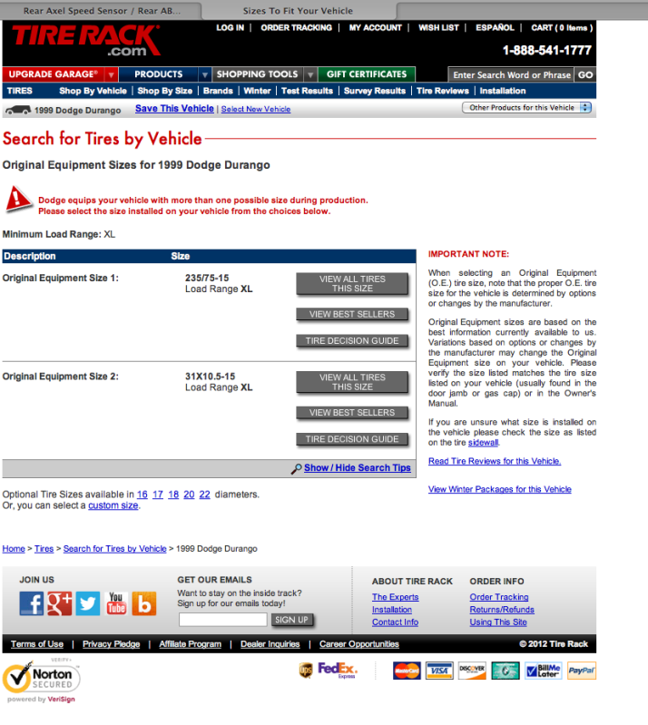

Alright everyone so this is crazy and I need opinions. I feel slightly stupid. So I do not have stock tires, but at the same time I do...
On my Durango I currently have 31x10.5R15.
My door jamb sticker as well as the dealership(based on my vin) says that my model takes a P235/75R15 stock size tire.
So obviously I am not riding on stock tires. So I go to tirerack.com and plug in 1999 dodge durango and look what pops up. Picture attached. Apparently Durangos come stock with one of two sizes. the 31x10.5R15 or the P235/75R15. Now how weird of a coincidence is that that I have the "other" stock size for a Durango???
So technically I have a stock size tire for a Durango, but for my specific model I have the wrong size on. I wonder if someone before me decided to get new tires and a tire shop said that those were stock size and based it on a differnt model Durango. So what do you guys think?
Is this causing my spedometer to track improperly?
I have oversize tires I guess, but technically I don't. Opinions?
And also now thinking back on it I am not sure if I knew the odomoter was working properly when I got it. I just thought it was.
How do I fix the spedometer being off? and fix it not tracking the right amount of miles?
