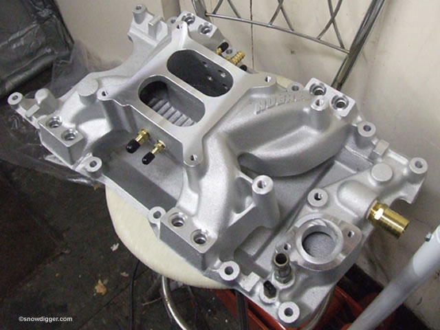

Upon review of his sig, he has a "F1 Airgap Intake." I know a traditional M1 eliminates the plenum, I have no idea on that intake. It isn't the most common setup.
IndyD
For those of us that never seen one:
Yeah, i would say the Plenum is covered.....

I have a F1 airgap so no worries about plenum gasket and throttle bodies. TB is super clean as I keep my engine super clean and well maintained.
