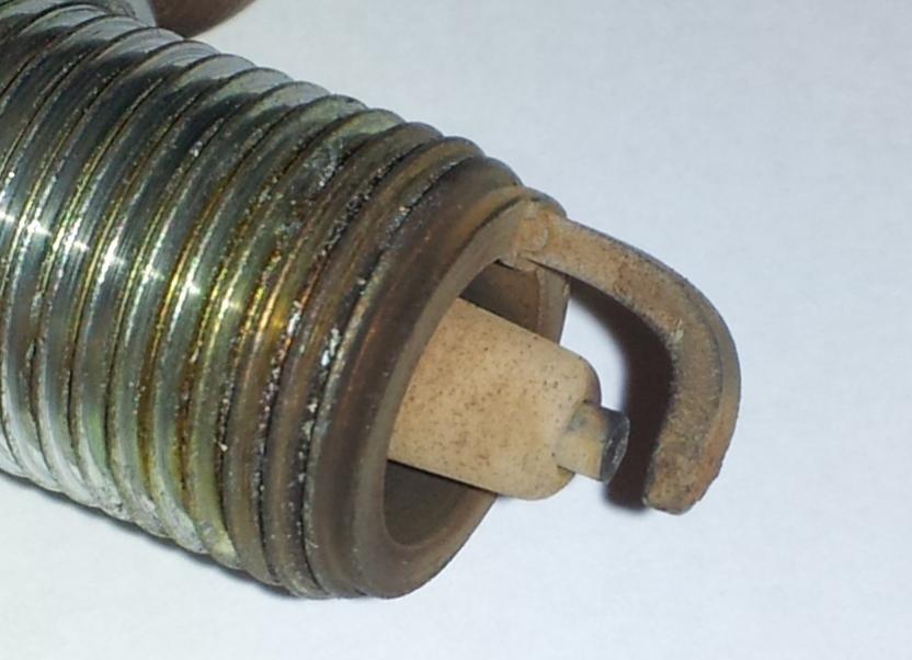

This plug is from the #7 cylinder. I noticed half of it is all black, should that mean anything?

Looks like you run fuel cleaners, and a lot of it too. It is not good to do that, and from the look of it you need to replace the plugs as well. Go get you a new set of Champion Copper plugs, yes the cheap ones and gap to .040 and install.
