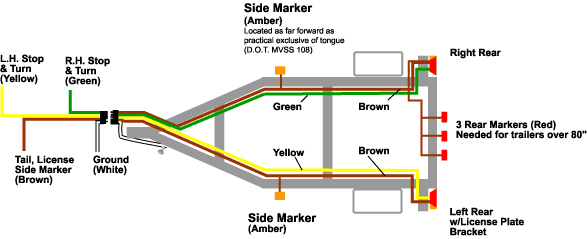

try a junkyard, our local one sells them for $12... you just have to pull it off yourself.
As for the wiring here is a diagram i made up when i was installing a trailer brake on mine hope it can help you too...
Here is a good one i found online at the time...
