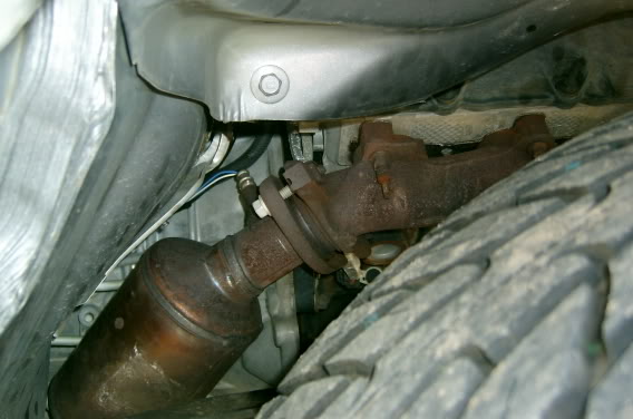

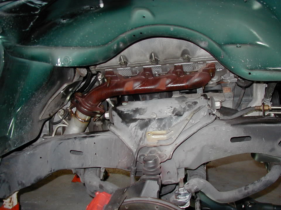

I was thinking manifold too but cant see any of the bolts. Wouldn't a lifter tick be more noticeable under the hood (top of engine) vs wheel well?
Old Jun 6, 2014 | 04:22 PM
gvsu4msu's Avatar
gvsu4msu
Joined: Jan 2014
Posts: 215
The fender liner or heat shield may be in your way?
Like I said, I would be more inclined for manifold bolt that lifter tick based on experience, but sound travels everywhere in open space.
