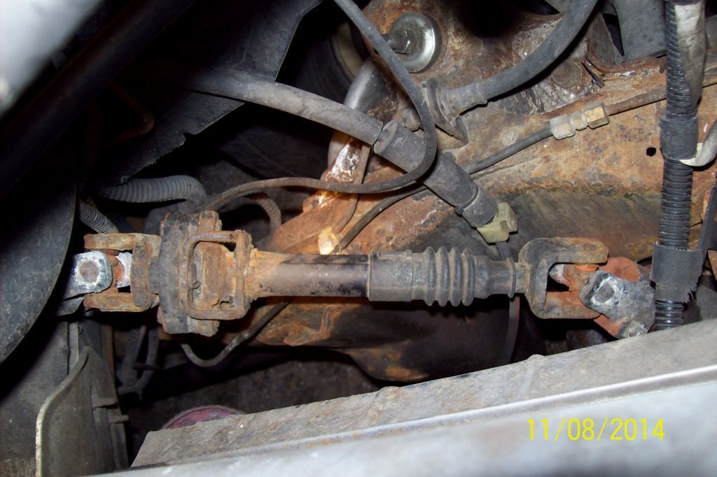

Right now i have a dead spot between 10 and 12 on the steering wheel there is no steering between 10 and 12, and when i steer to the left, it feels like its drifting to the right.
I looked under the hood and it looks warn out. I attached a picture so maybe you can see what i mean. thanks.

I replaced that part on my Rango. It's called the lower intermeadiate steering shaft. I bought mine from
stores.ebay.com/KINGSCJDPARTS
It was super cheap and easy to replace. The small u joints wear out and make steering sloppy. I think if you look for asphaltwarrior1 or LDavis on youtube you can find my video of the replacement. It's just an informational video and not the actual replacement. I hope this helps some

ooops forgot to add it's the second one. I think that first one might include the part that goes inside to the actual column. I paid like less then 50 bucks I think shipped, or slightly over . My memory is not so good these days.
