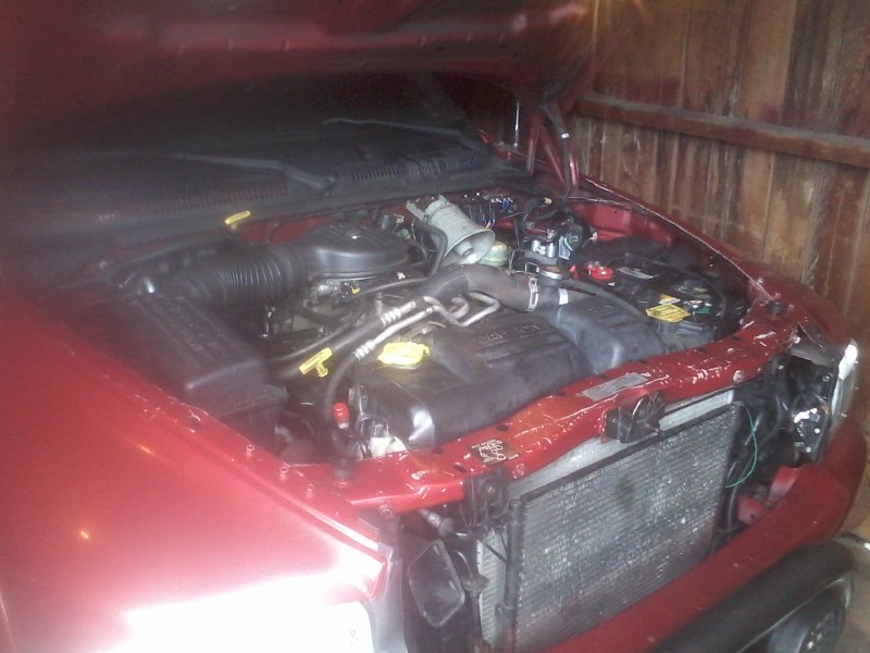

When I did mine is when I "converted" to the 2001 cooling system so I would have the room to install the OEM e-fan.
