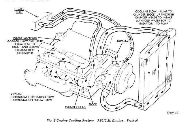

I just went through something similar to this in my ram, these 5.2/5.9 are notorious for having a hard time burping the heater core. Here is a thread I started over in the ram section, useful info on Burping the heater core
