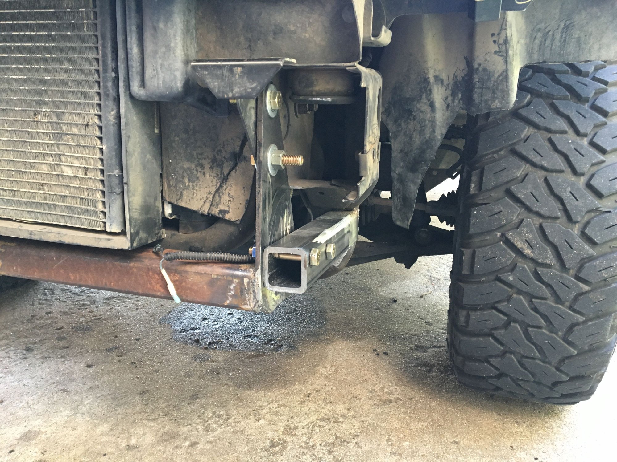

This is just taking the bumper off. Not a lot of room to get it as high as I wanted due to where the condenser is.

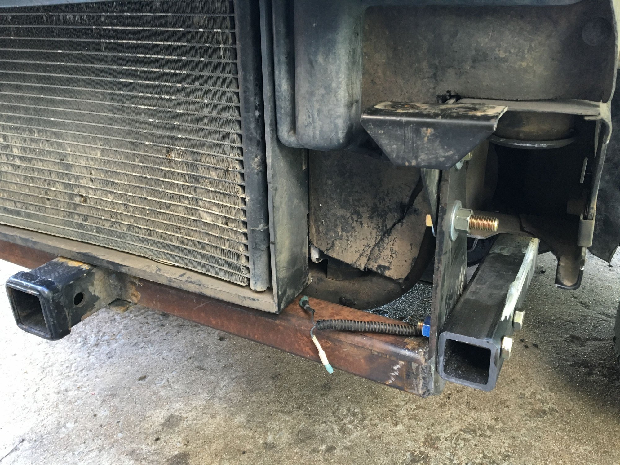

I cut a notch in each frame rail to allow the hitch bracket to sit flush everywhere. I only took pictures of the passenger side of a lot of this stuff.

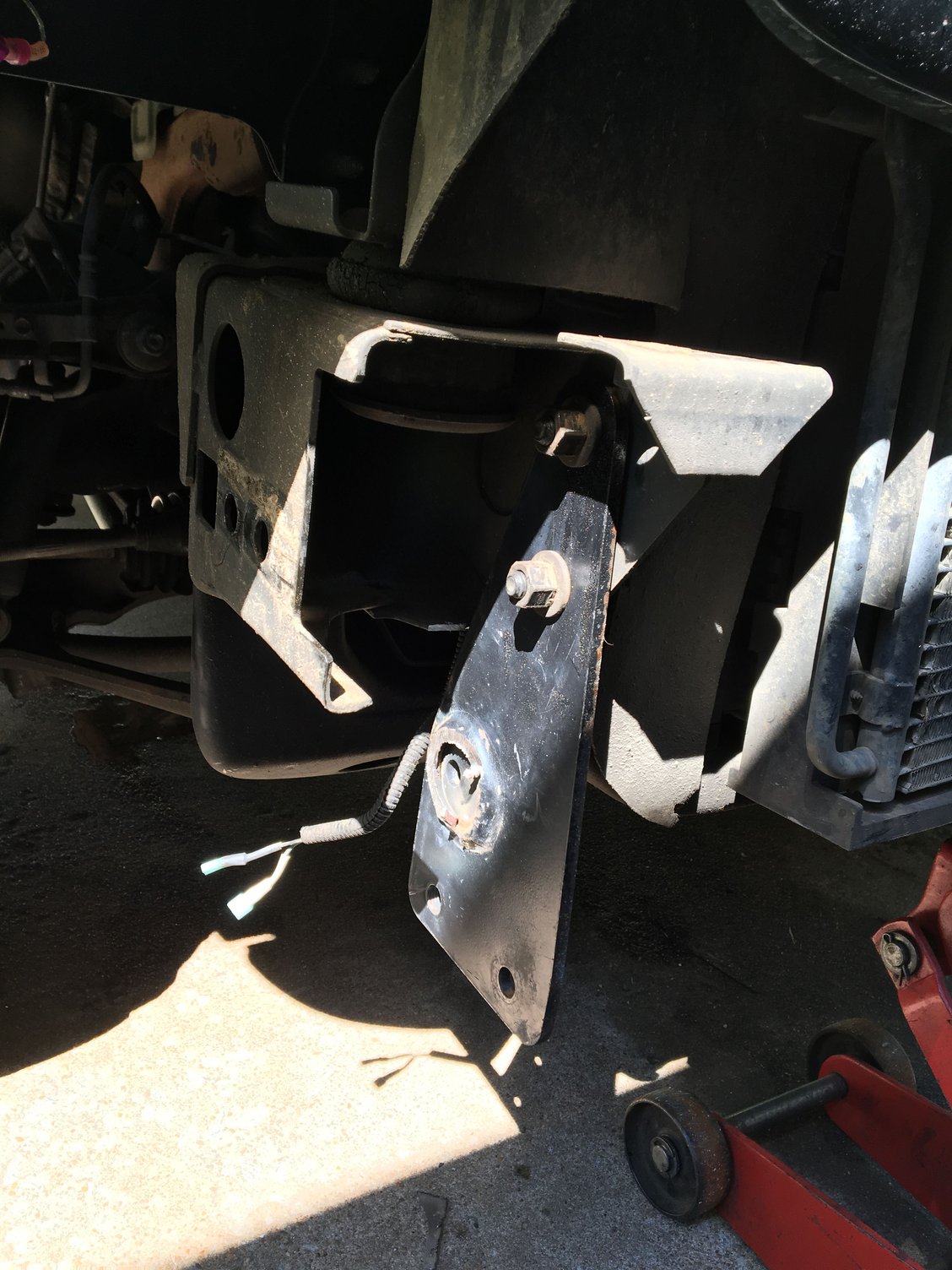

The picture below is with the bracket bolted to the frame using the original bumper bolts and placements.

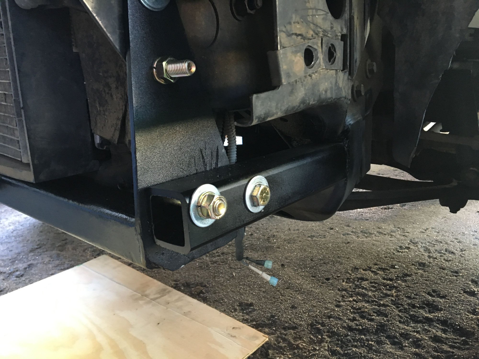

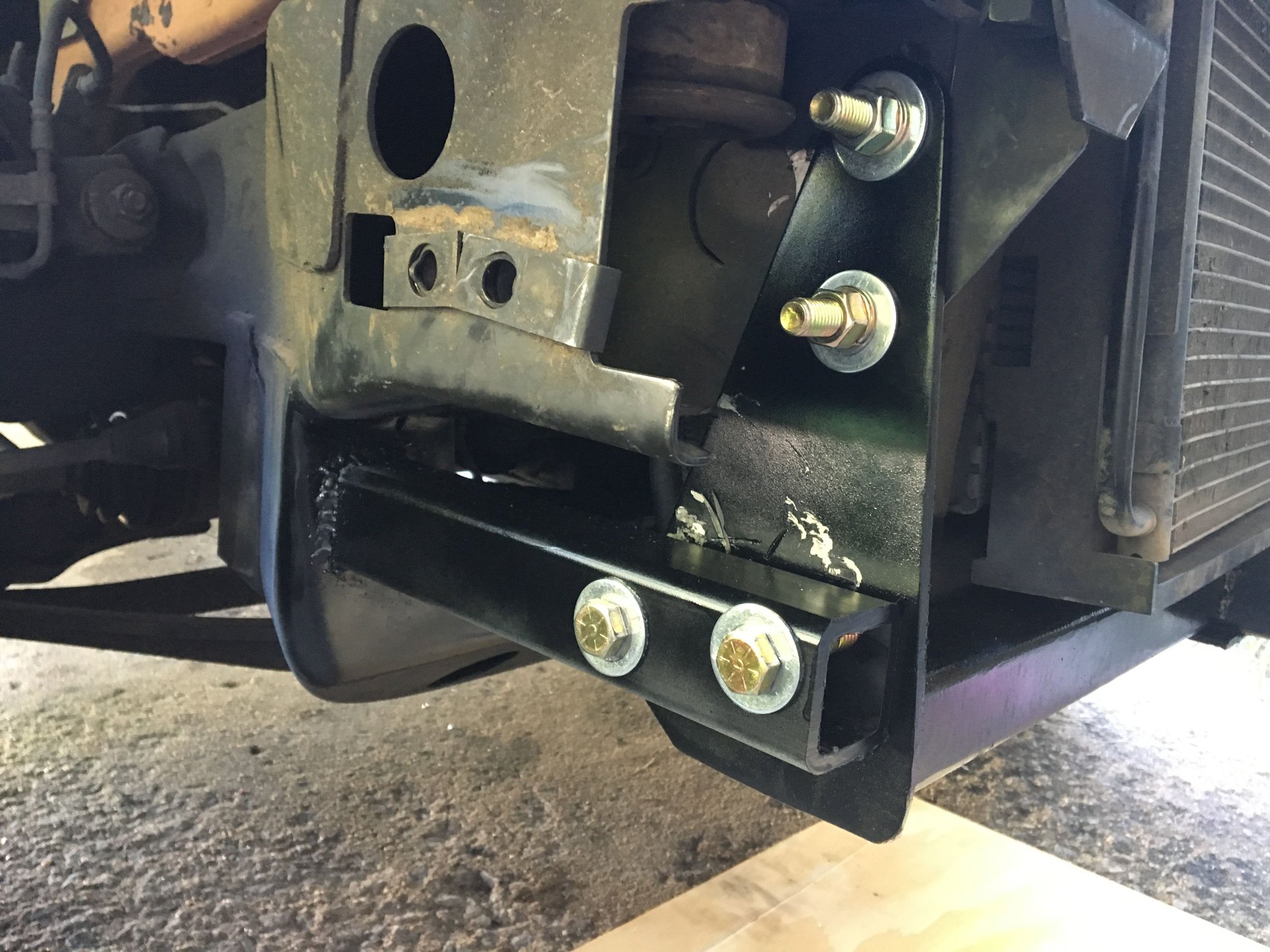

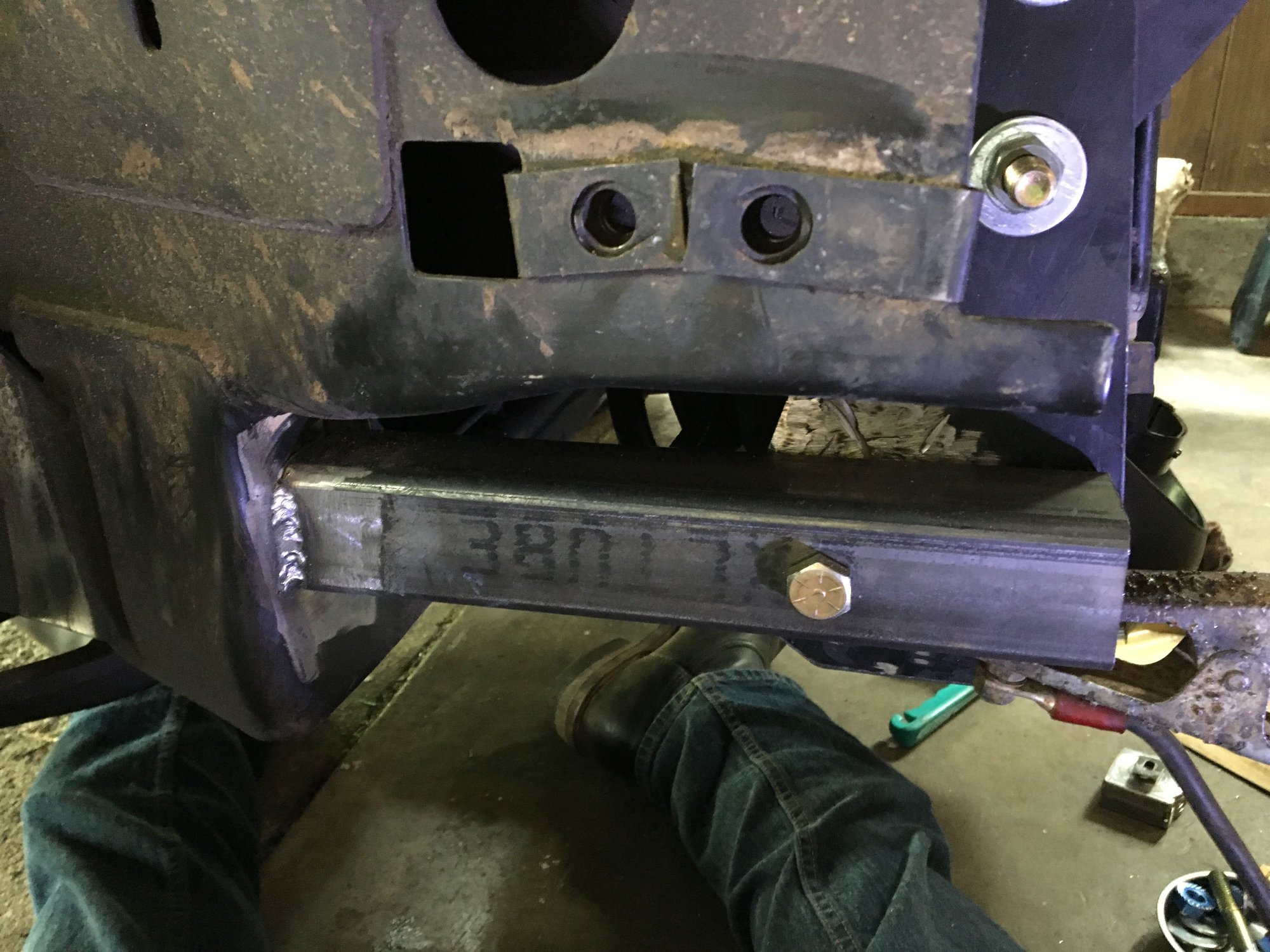

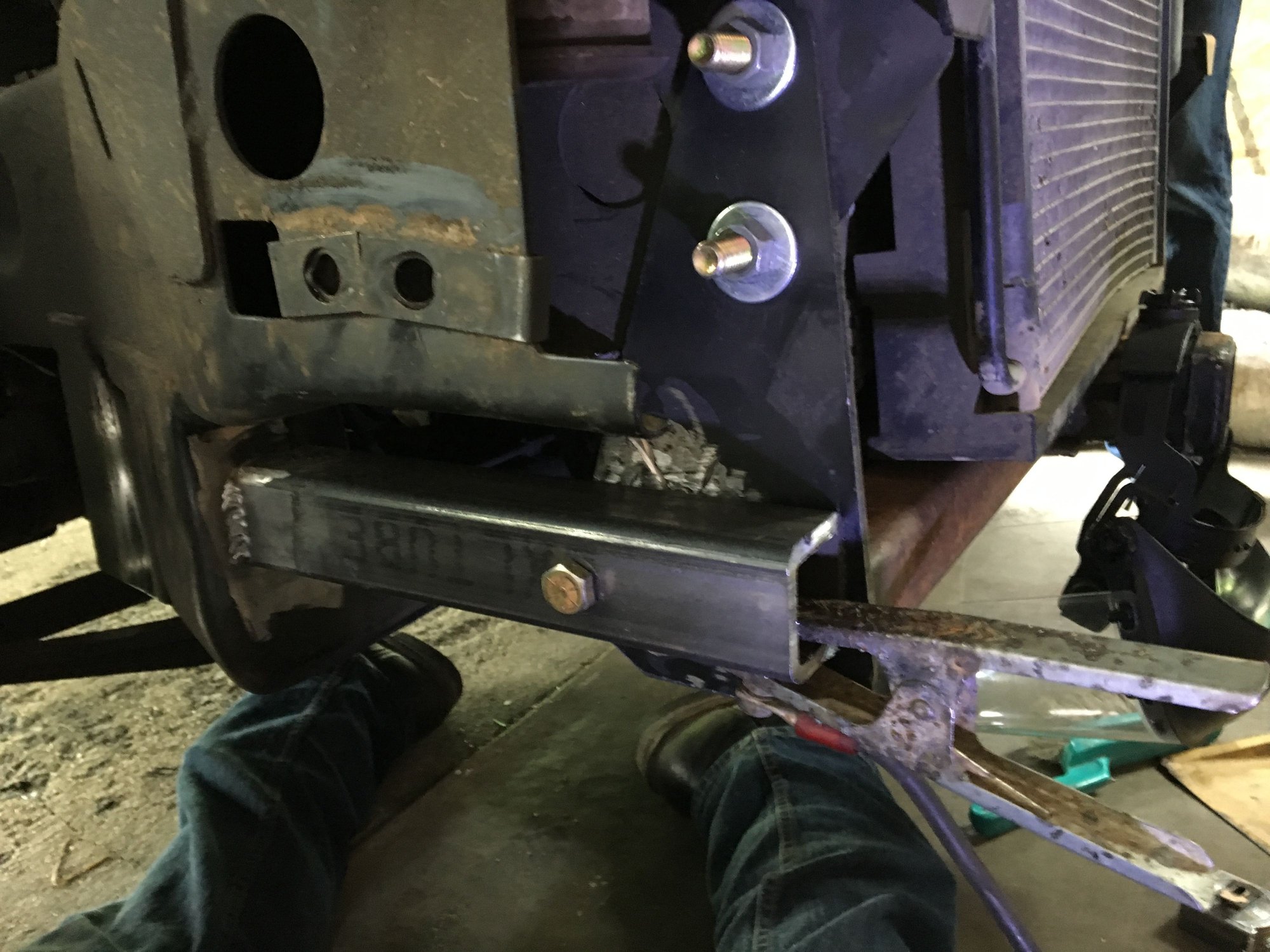

The three below are with the brackets mounted to the frame rails on both sides. Then I cut and welded the 2" OD square tubing to the brackets. then I found the center and measured 1 1/4" out from center on both sides and cut the square tubing to fit the receiver tube (2.5" OD) in the middle and welded it all up level and even.

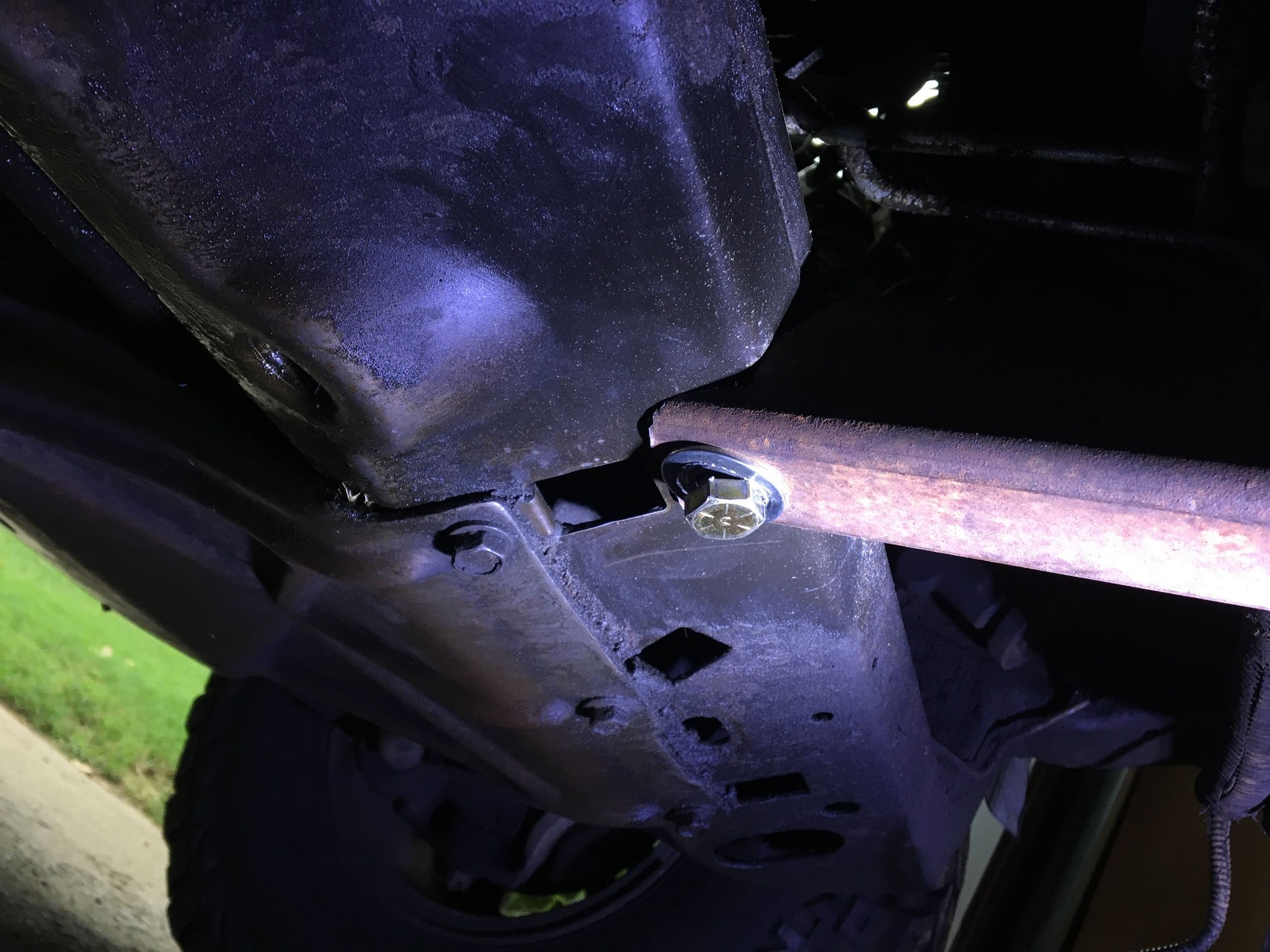

The underside brace. Probably the weakest, most poorly designed part of this entire build. It's welded to the hitch frame and bolted to the Durango's front cross member. Probably should have welded to the crossmember and made a two bolt system to bolt to the hitch. But oh well.

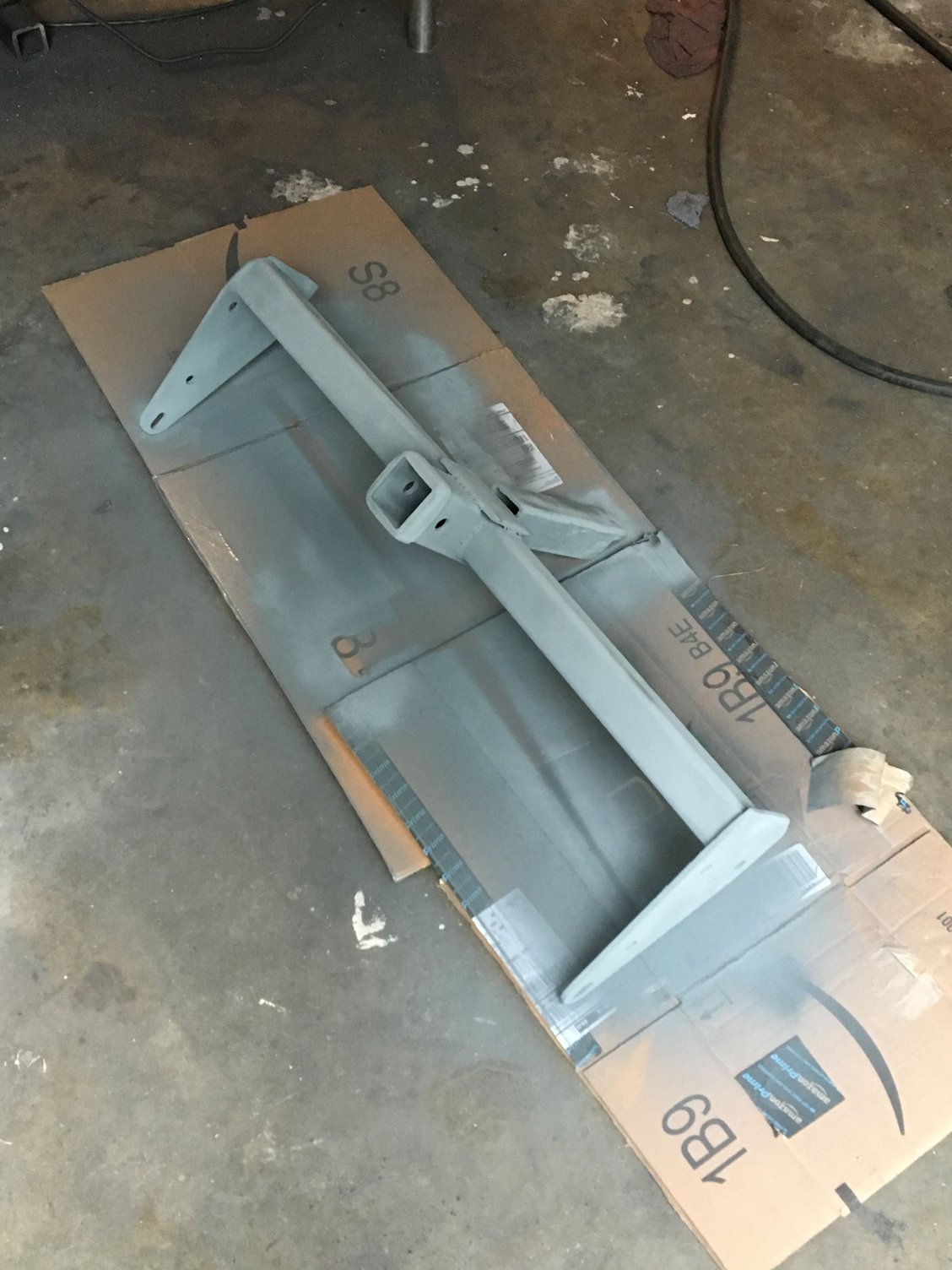

I ground down where the old round tubing had attached to the brackets to make room for my forward facing braces. They are once again made of 2" OD square tubing. They're welded to the outsides of the crossmember with 2 bolts into the mounting brackets on each side. These 4 bolts will be upgraded to either 5/8 or 3/4 bolts because this is where all of the real strength and support comes from.

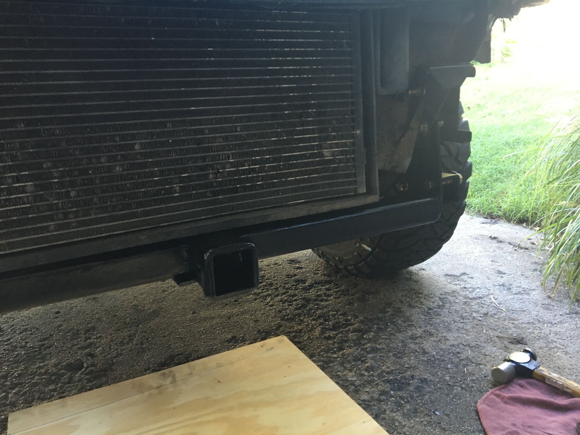

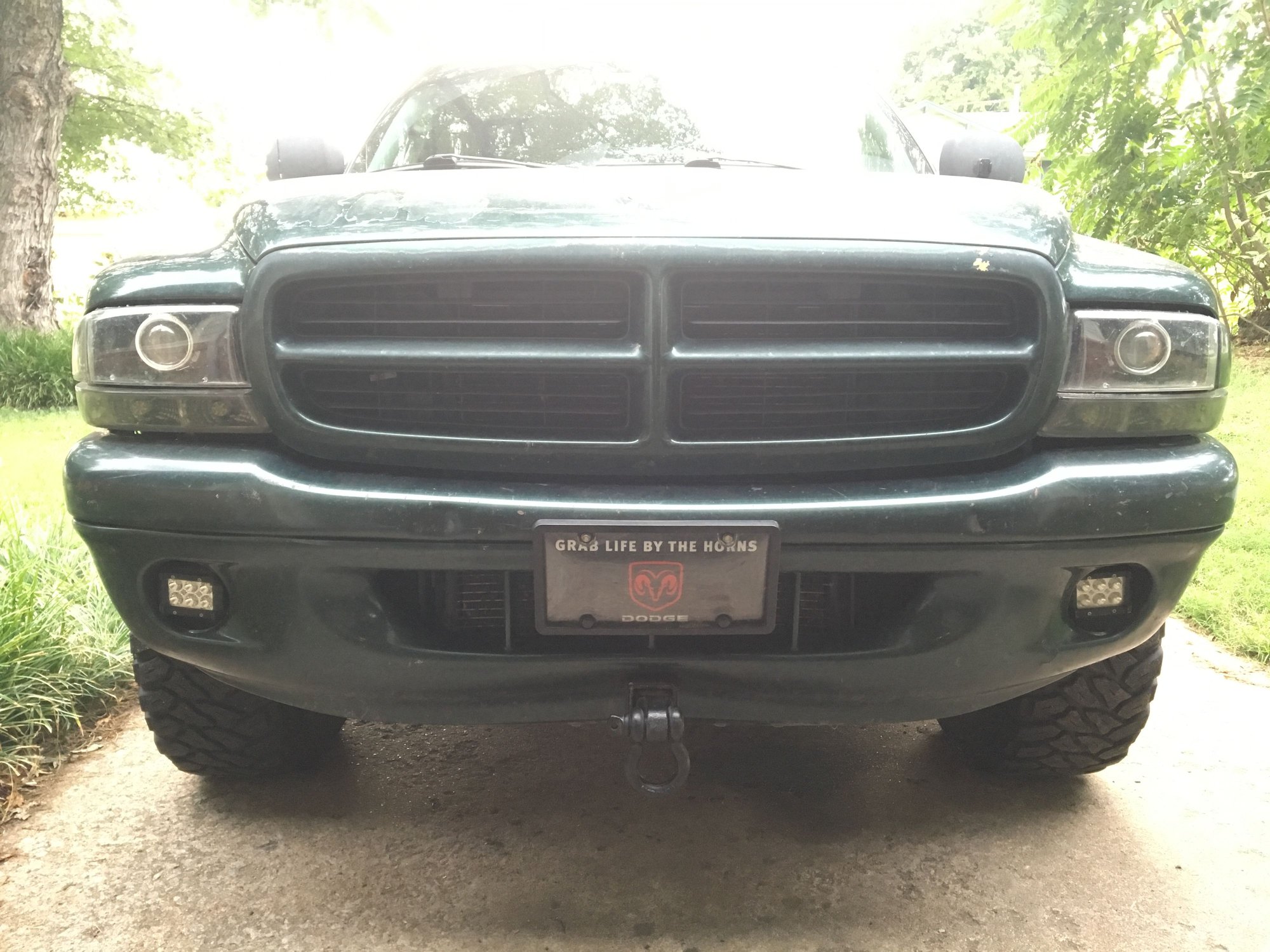

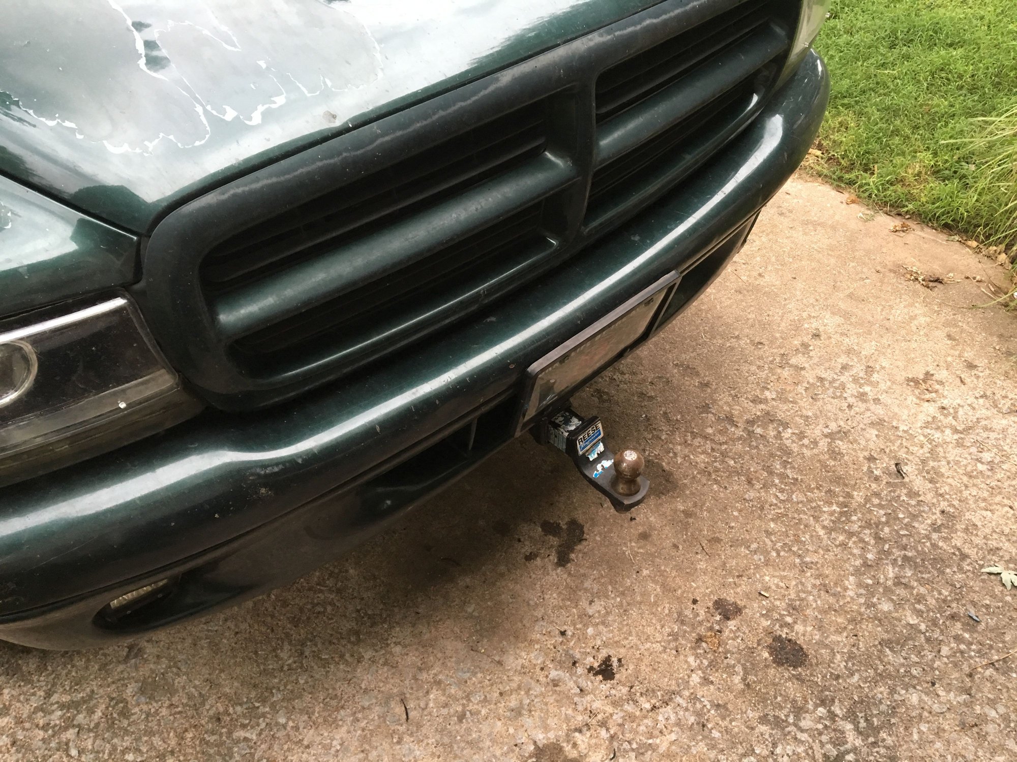

Now I took all of the paint and rust off so that I could prime and paint. It all dried overnight, and is back on the truck today. So these are the final pictures of it all painted and mounted up.
I will put the bumper back on later and post another picture or two once that's done.
