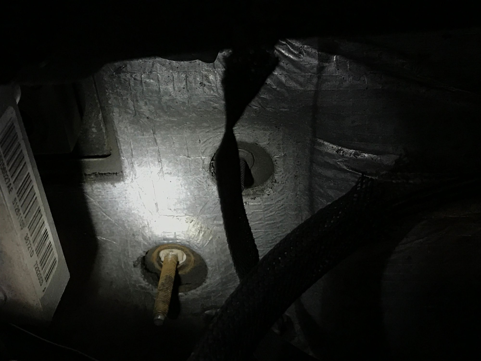

Hello. Replacing both the heater and AC cores on my 2003 4.7 Durango. Got the dash out and steering column lowered. Cannot find the 4th pesky bold on the firewall. Anyone have a location for this allusive monster?
Thanks much.
Below are some images.
Passenger side towards center of engine compartment.
Passenger side near AC core.
Drivers side near heater core.
Last edited by Eric Hanke; Jan 15, 2017 at 01:43 PM. Reason: Delete Duplicate Images

I think it's behind the PCM
Step 7 Remove the powertrain control module (PCM) from the engine compartment to gain access to the HVAC housing retaining nuts
Step 8 Remove the two nuts from the HVAC housing mounting studs in the engine compartment.

Thanks for the responses. After a few hours of hunting I found the last bolt. It was hidden by the foil thermal barrier. The bolt is directly behind the oil indicator tube. It was a tight fit.
