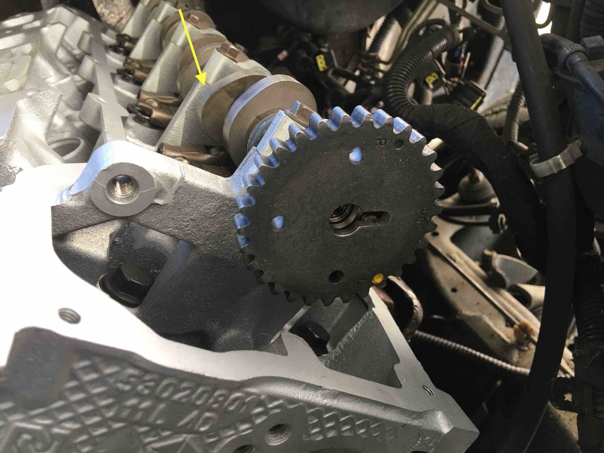

Hello all. I bought a rebuilt head for my 2000 Durango. Unfortunately the camshaft is not in the TDC position but off about a quarter turn. I know I should have checked but I wrongly assumed that "ready to install" meant the machine shop had actually set the cam at TDC. Luckily it's not hitting any valves. I can't turn it without hitting. Can I just pull the cam and reset it without bending the cam? I've done that on many cars just not sure of the outcome on this vehicle. I can slowly and evenly remove the caps but I just wanted to check here first. Thanks for any input.

As for ready to install, they were. But there is no way to set the cam timing because they likely put the cam in a position where all/most of the valves were closed for safety during transport. Plus it is possible that the pulley will need to be held to keep it lined up during the install.
In theory, once you remove all the chains you should be able to get it all where it needs to be. If not, there is no secret to camshaft removal, just remember to keep everything super clean, especially the cam journals.

Thanks for the help b1lk1! After staring at this head for way too long I'm starting to think this is the wrong cam. Head is right but if I align the cam to the timing marks the valve will be open. If I align the cam lobes to TDC the timing marks will be upside down. UUhhggg. I appreciate your input.

OK, from what I have read you need to pull the rocker arms off and then line everything up. You'll need a special tool to do it, but I would think you could rent it somewhere. Once you pull all the rockers you line everything up and put the chains on. After that, install the rocker arms and turn the engine over by hand. If it does not want to turn somewhat freely then you may have an interference issue, but from what I can make out from the videos online is that your cam will be in the right position once you do this. I am not 100% positive about your cam, but the amount it needs to turn should put it where it needs to be when it is fully assembled.
MAKE SURE YOU TURN THE ENGINE BY HAND TO FEEL IF THERE WILL BE INTERFERENCE FIRST!
