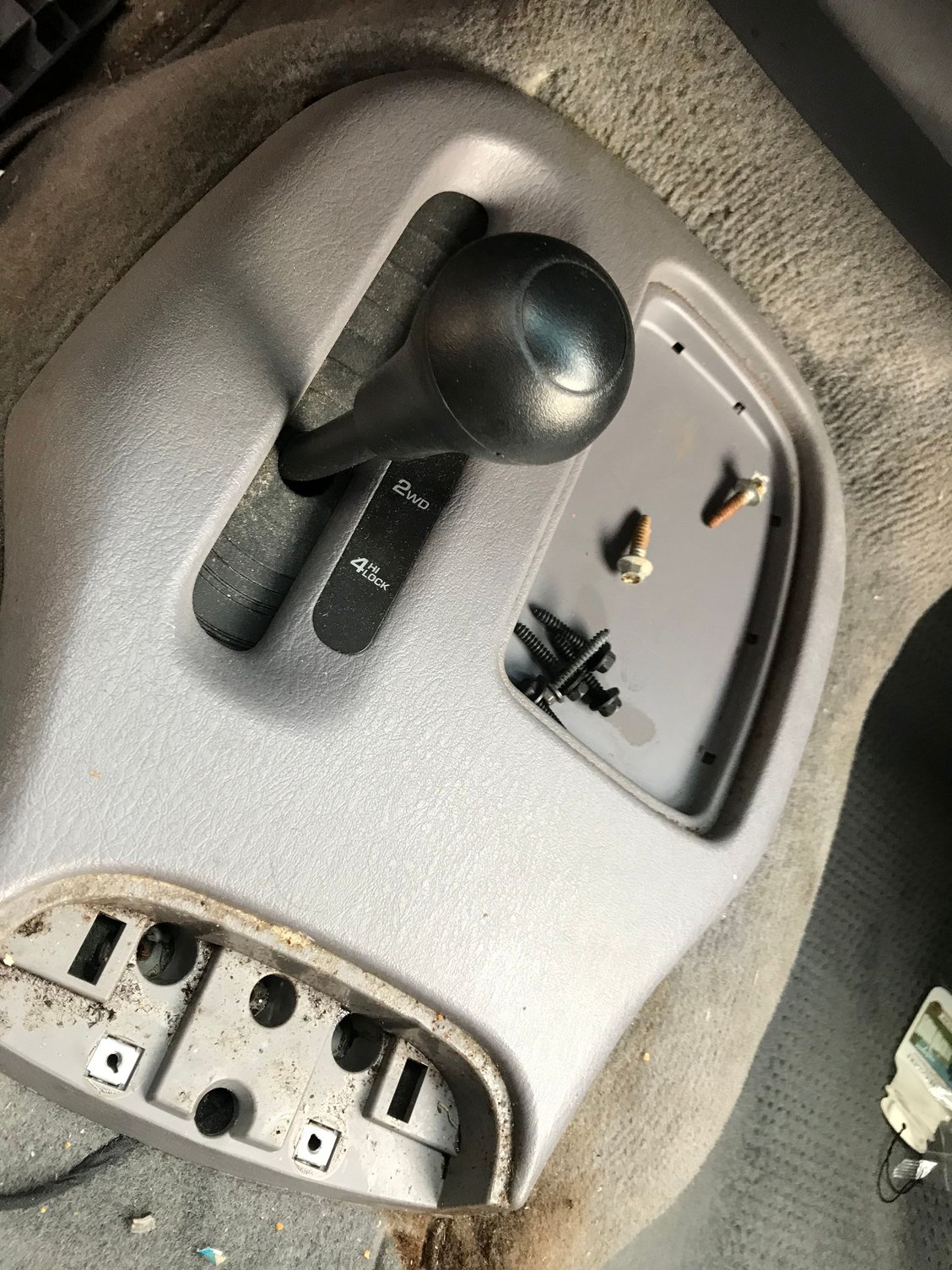

Need to get this consol piece out so I can clean it & the carpet around it. Is it a twist ****? Thanks

Mine is only different in that it has the shift pattern on it. That little circle on top is a plug. Pop it out with some non marring tool and there's like a 15 or 17mm nut under it.
