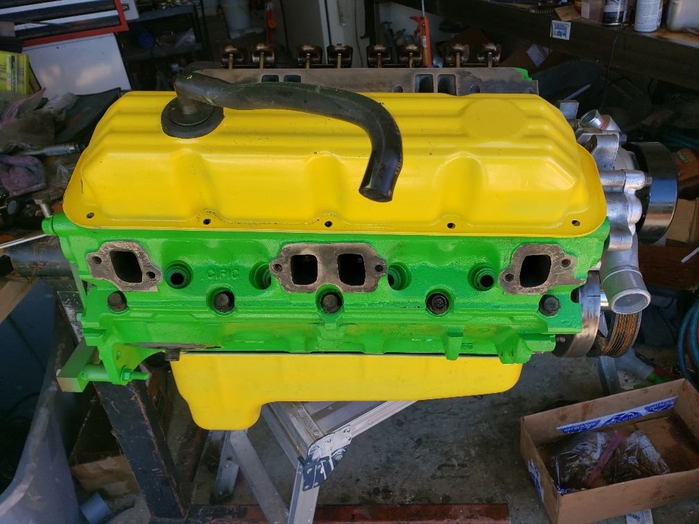

As for paint, We didn't paint the manifold but we did paint the motor :
See there is a story behind the paint job...it seems my son was more interested in chasing his girlfriend around instead of helping his grandfather and me rebuild the Durango...so Dad and I went BOLD colors....Dad wanted Hot Pink and Green, but the pink was a special order...so Daytona Yellow and Grabber Green it was
Best of luck with your project...cannot wait for updates...
Steve
