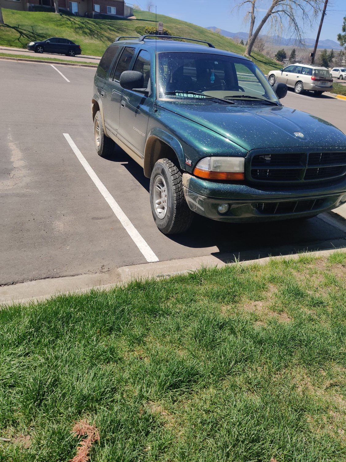

Hey everyone! I have a 1998 Durango with the 5.2 in it and my trans is going out. A friend of mine says he has a 2002 Durango with the 5.9 that I can have for free as a parts truck. So my question is will the transmissions swap and if the will do I need too do and modifications to make it work unfortunately I do not know what transmissions are in either vehicle as they are both far away from me any tips or tricks is also welcomePic for attention
