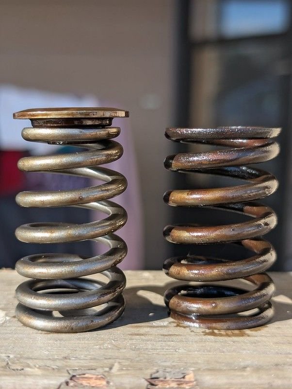

Using the Rock Auto parts look up, I ordered EngineTech # ERV1432 valve springs but come to find out, my engine does NOT have Conical 0.635" I.D. valve springs. But Conical is the only valve spring choice on Rock Auto. Anyone seen this before? I.D. of my original spring is 0.845".
Pic of valve springs. EngineTech # ERV1432 on left with original retainer on top. Original spring on right...

Or does the small end of the spring go down? Larger end, up?

I got Mopar springs when I did mine. 2003 Dakota. Dug up an old pic of mine and they look conical. Part # 53020749AC.
I know there were changes throughout the years for the 4.7L but I don't know if the earlier versions had different valve springs. Try shopping on a Mopar site using your VIN and see what it pulls up. Maybe you can just get new retainer caps that fit the conical springs. Those are 4781090AA and in case you need it, the retainer locks are 53022277AA. Those are part numbers from my receipts.

I did a bit of internet digging. MoparPartsGiant has about the best price shipped that I could find. So the newer style retainers are on the way. Some of the sites list the application range as 2001-2011. I also found a Jeep Cherokee owner in the Jeep forums with an early 4.7L Cherokee who described the same issue I'm seeing. So, my assumptions based on available data is likely 1999 and 2000 model 4.7L's could have had different valve springs and retainers. I did search the Mopar parts sites but could not find a valve spring or retainer for my year so these parts have probably been long discontinued? Again, just a guess.
Oh boy! Now I have to re-do number #2 cylinder when the parts come. Yay!

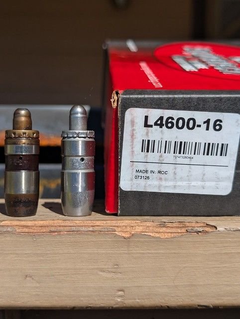

Valve Lash Adjusters: ENGINETECH #L4600, new, OEM / Interchange Numbers: 53021077

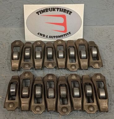

Rocker Arms: #53020742AC, used, updated "small hole"

Below: Mopar Retainer #4781090AA on top of ENGINETECH #ERV1432 Valve Spring. Notice Valve Spring is MADE IN USA. Could EngineTech be getting their valve springs from the OEM Mopar supplier?
Below: Believed to be original, the as removed valve lash adjuster on the left, #53021077 and new ENGINETECH #L4600 on the right. MADE IN Republic of China

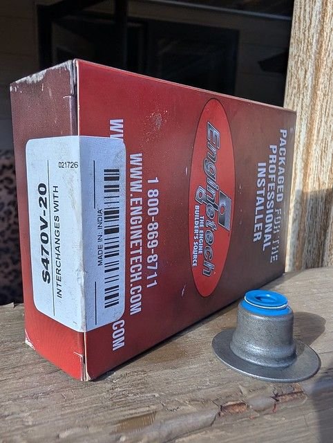

Below: ENGINETECH S470V Valve Stem Seals, MADE IN India
Below, the updated later style "small hole" rocker arms. Not sure the exact part number, but likely part number #53020742AC

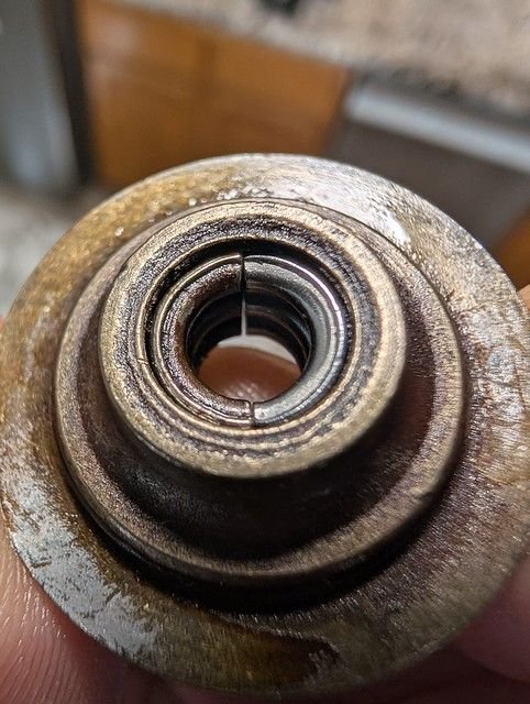

I used my original valve keepers and became concerned that keeper revision #4536513AB started the same time as the retainer revision #4781090AA. I wondered what difference could there be with the AB added to the end of the part number? Upon close inspection, my eyes cannot see any major difference between the stock keepers #4536513 and the few extra Melling keepers I purchased just in case I lost one. The Melling part number is VL-1093 and has a OEM / Interchange Number: 4536513AB
The next three pictures, below: Original retainer #53020750 with one-half original keeper #4536513, left, and one-half new Melling keeper #VL-1093, right. Note: I did not mismatch keepers during assembly. The below pictures are informational for this post only...

So between comparing the new and used keepers side-by-side and and getting confirmation from the Melling website, I'm fairly confident that my original non-"AB" revision keepers #4536513 will mate as intended to the new revision Mopar retainers #4781090AA with NO problems. Wow Mopar!!! How confusing.
