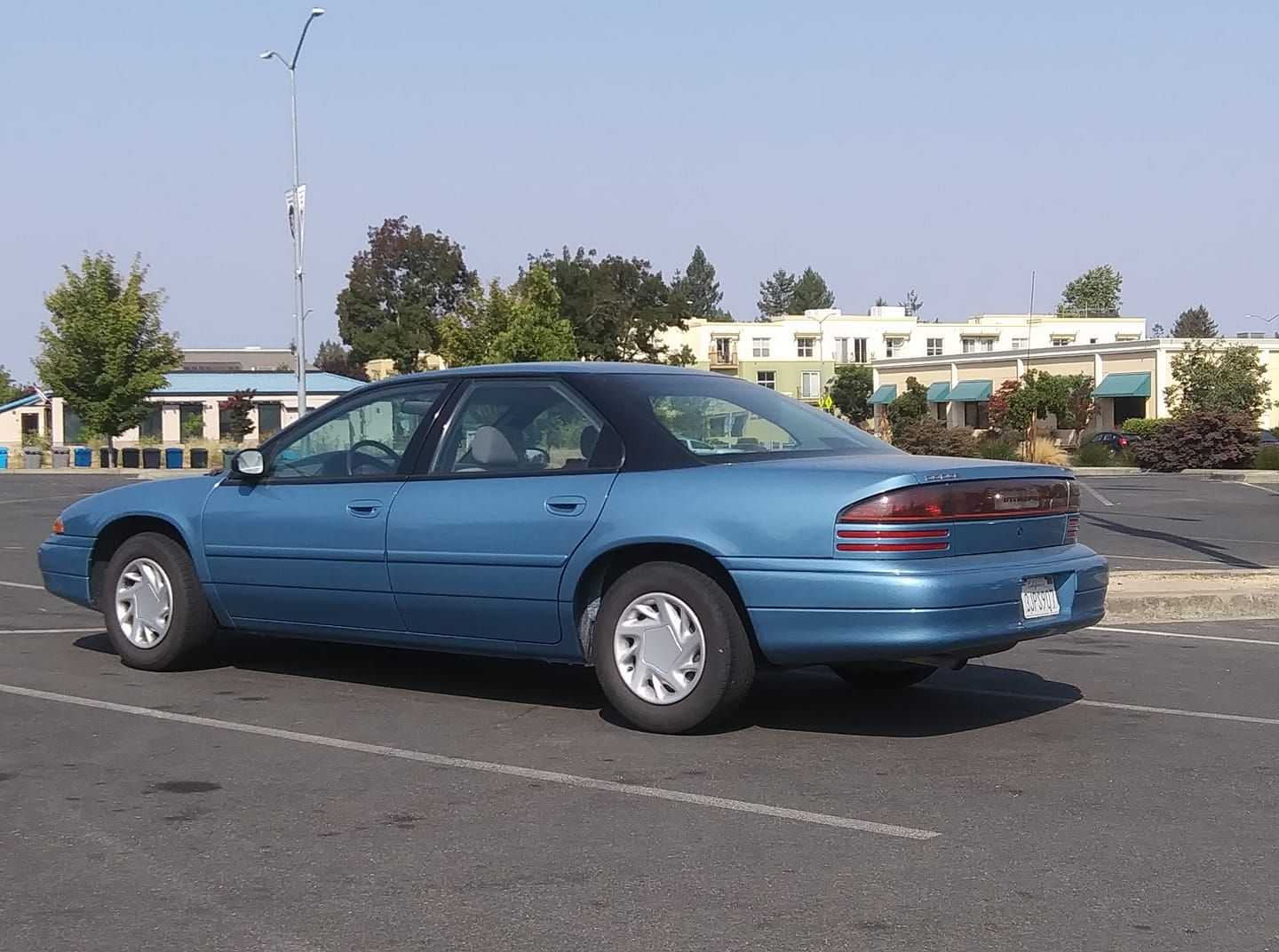

Originally Posted by TNtech
I can't believe a 95 Intrepid still exists.
Still a daily driver and looking good.
Photo from a month ago.
