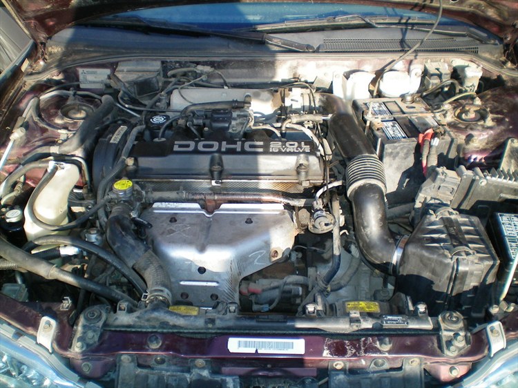

This is a ECC engine from a dodge neon. Note the intake manifold orientation.
This is a 420a engine from a Eclipse. As you can see they are on opposite sides of the motor.
I might not be able to drop in and bolt up

The intake manifold from a 2gn Mitsubishi eclipse will not fit on a neon, and would not increase performance enough to warrant fabrication. Are you looking to modify your neon?
