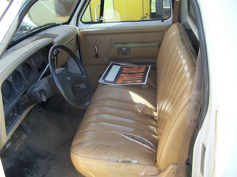

what years could this ram be? its a v6 thats carburated. its got an auto tranny but not shure is its a 3 or 4 speed.
heres some pics.
whats the reliabliity on these things?

could tell you what year it is from the VIN. Looks alone 1986- 1990 because of grille, vin codes are as follow for years:
1986- G
1987- H
1988- J
1989- K
1990- L These codes will appear as the 10th digit code in the VIN.
Don't know ofV6 reliability but the V8'slast a long time without problems in taken care of.
