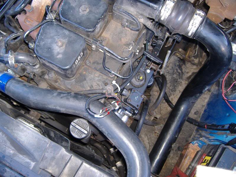

here are the pics of the install..before final heat shrink or dash mount...
this pic is of the TPS connector top clip up..with new cable conductors numbered for easy reference...
#1 green
#2 black
#3 white
T - TPS stock connector...no changes to it..

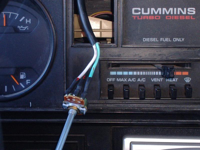

pic is of linear 5k ohm potentiometer in dash..not mounted..
wires identified for easy reference to previous pic...
#1 green
#2 black
#3 white
#1 green
#2 black
#3 white
#1 green
#2 black
#3 white
