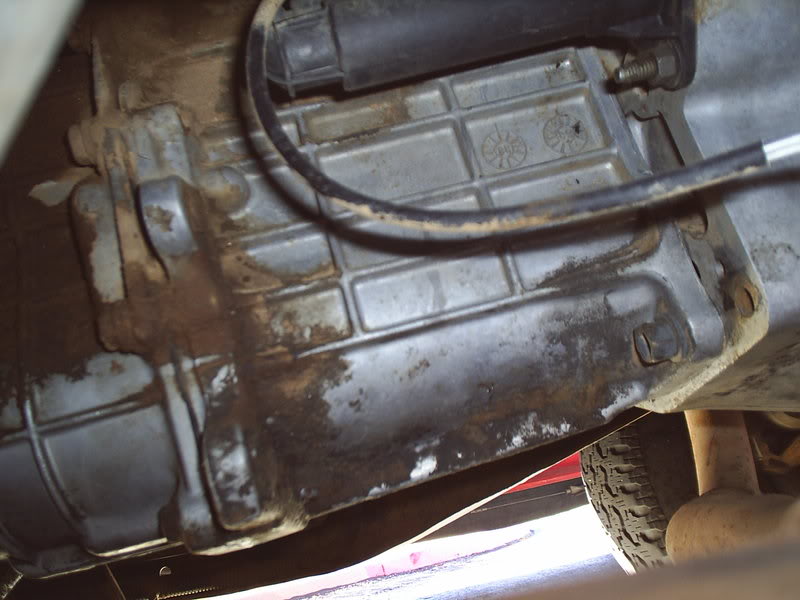

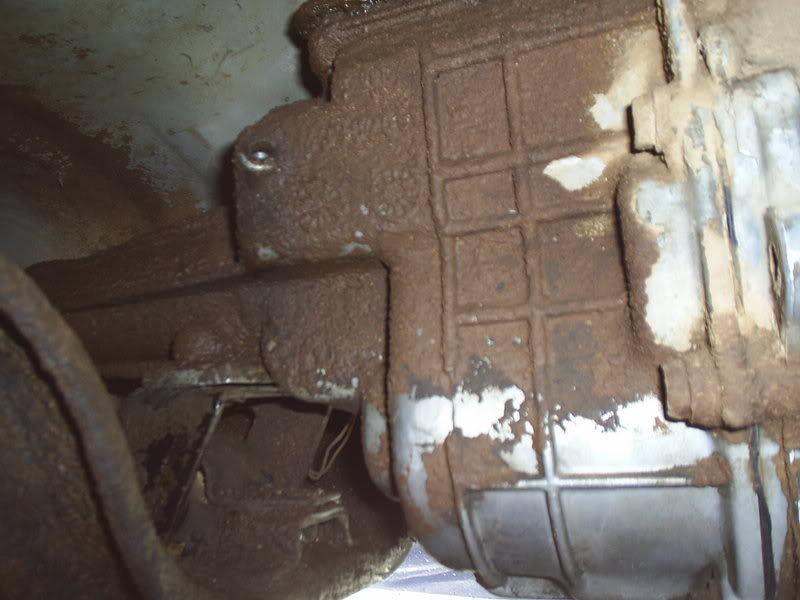

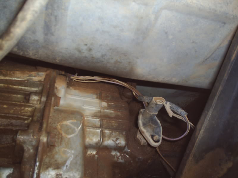

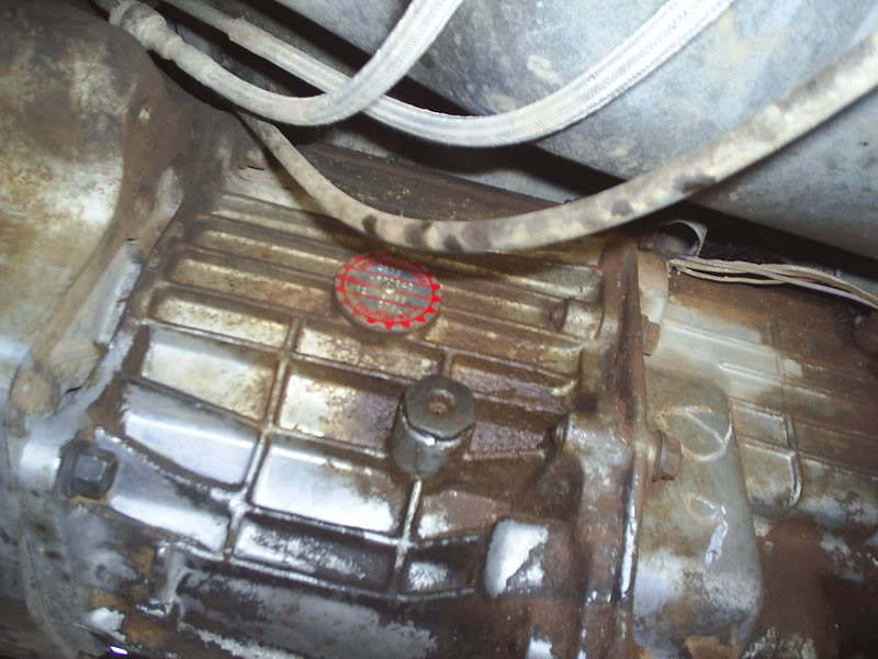

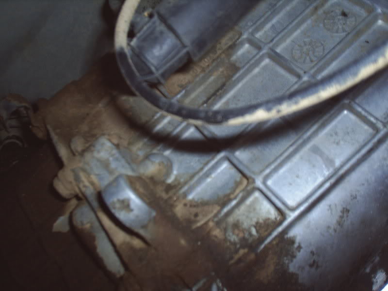

Here are the pics I have of the trans, as you can see there aren't any identifying marks or stamps on it anywhere except for the red stamp which states model #453S or A53S. If you see anything please let me know. Thanks again.

i see markings cast into it on the first passenger side pic. Clean that area and you'll probably find the info you seek.
