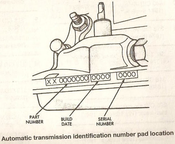

I have a 1990 d150/2wd/318.
Is there a way to tell what transmission model I have without taking the trans out? I cannot see or find any markings or numbers on it.

i don't think there is a set of headers that that would fit a stock y-pipe. it would not make sence. a stock y-pipe and headers. usually if you get header you get a custom exhaust system. and this picture should help identifie your transmition.

What's the "Code", for the transmission build date? When I was under mine, and checking it out, I saw 235 04 for the build date.
