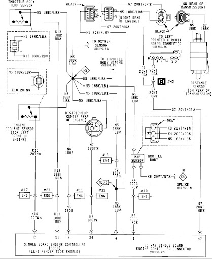

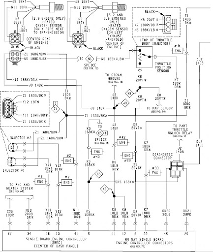

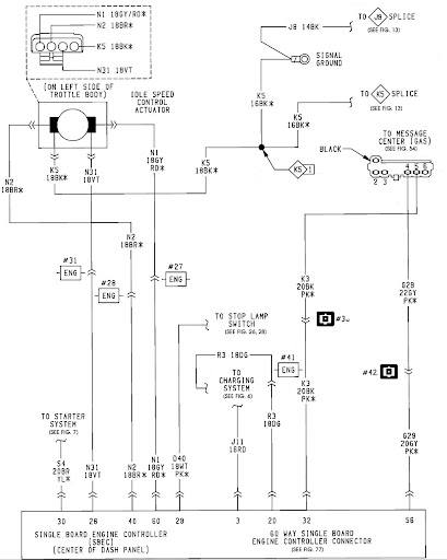

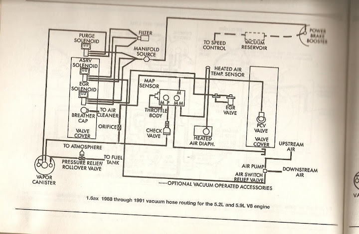

Hi, I have some probs with my w250. One of the owner before me removes some parts of the vacuum-system and change a lot of the electric. The TBI is still there but on petrol it runs very bad. The Truck runs on petrol and LPG.
I would order a Haynes or Chilton but it takes up to four weeks to send it to Germany, also with amazon.
It would be great if somebody can help me with a diagram of the vacuum/fuel system and a diagram of the electric?
Thanks Markus

http://lh5.ggpht.com/_u26Z1RDZ_Po/Ss...s512/part1.jpg
http://lh5.ggpht.com/_u26Z1RDZ_Po/Ss...s512/part2.jpg
http://lh3.ggpht.com/_u26Z1RDZ_Po/Ss...s512/part3.jpg
http://lh6.ggpht.com/_u26Z1RDZ_Po/Ss...s720/truck.jpg
