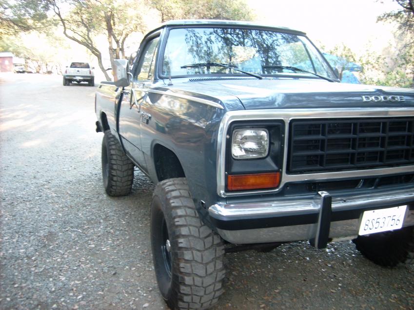

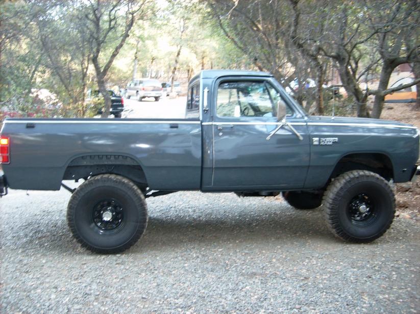

I have a tired 318 in my 83 w150. I found a 5.2 out of a 98" durango 35k wiring harness and computer for $1250. what should i do rebuild the 318, find a 360 or use the durango engine? i have about $2500 to work with. have any of you done this swap? thanks
