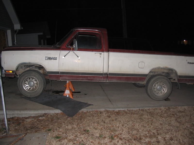

Grandpas truck
Purchased by Grandpa new in 84
Sold to me in 2000 with 48k miles
I then read the 2003 Hot Rod Magazine "junk yard jewel" 318 engine build up at 50k miles.
this is what it is
1984 long bed 2wd
318 v8
1988 360 4bbl heads, ported and bowled
Edelbrock performer cam, lifters, intake and carb with a spacer plate
flow tech headers
Tom's muffler exhaust system
now I am not saying I matched their performance, but they were able to dyno 423 hp with this combo. I followed it and had excellent results.
Then-I got broke ha ha
2005 sold to neighbor across street.
I gave him a trans filter and gasket which he never used. 13k miles added in this time frame
flash to now. I just bought it back for little and my oldest son now wants to give it a go.

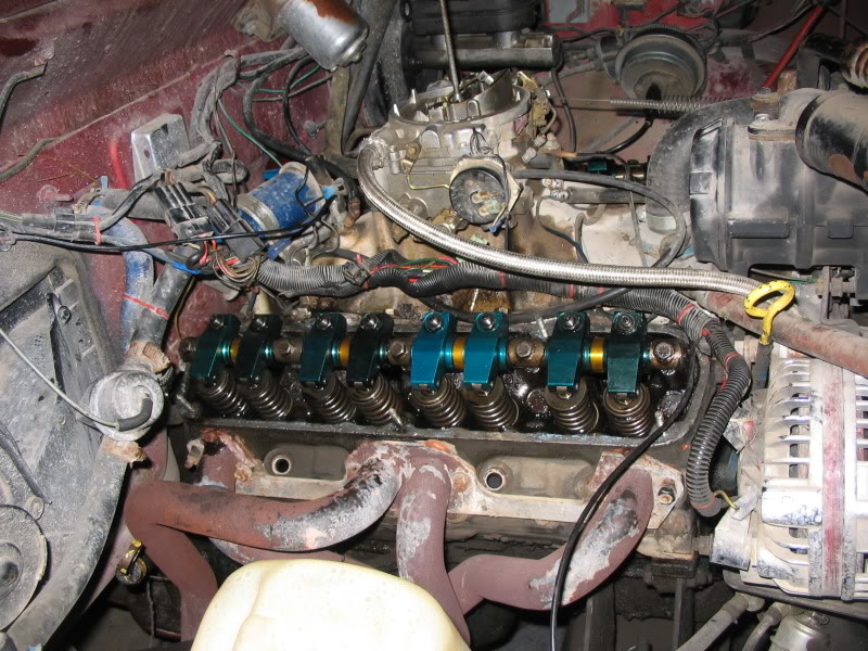

We got the rockers all adjusted, they were all about 1/4 turn loosened so that is good even wear!! This was the first adjustment since the camshaft was broken in so I am happy happy.
Looks like all of them are opening the valves over 1/2" so in this area I am optimistic.
We also acquired some lucas zinc additive stuff and Rotella oil as this is supposed to protect this area the best.
