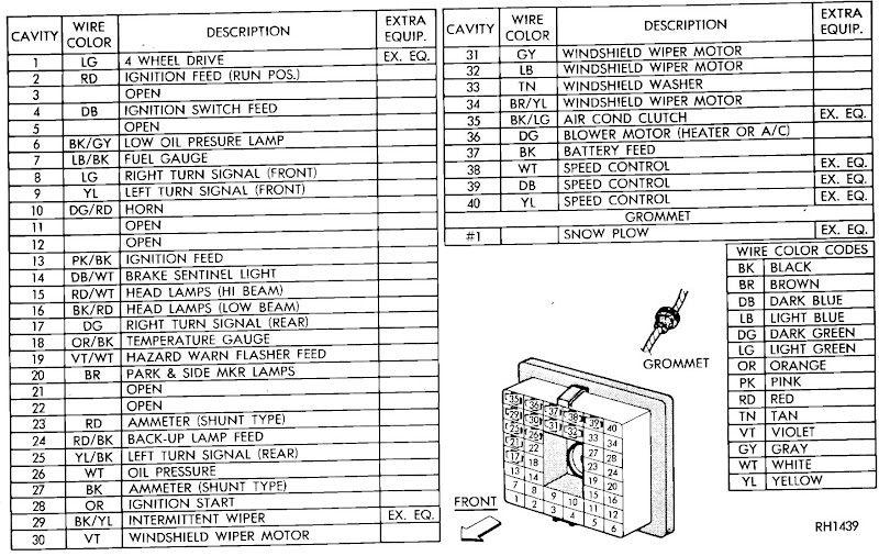

did it run when you got it?
i would be checking for power at your 40 way disconnect.

I just checked the firewall connector. Everything looked good, nice shiny terminals, no rust, little dust, no burnt wires, on either side of the connector. Could there be another relay that I'm overlooking?

I think I found it. I started following the #4 position line, and the fusible link was broken, but the insulation around it was not. I'll know once I get back from the parts store.
