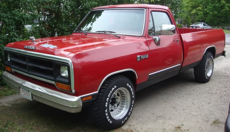

8x6.5 is the bolt pattern. Like he said, most any pre 2000 8-lug wheels will work. Some still are the same past that date too.
Got mine from a 2000-something Ford I believe.
