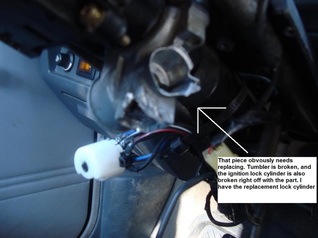

What I need to know is, What is the correct name for the part that the Ignition lock cylinder & the Ignition switch enter on the steering colum? (I can add a picture of the entire assembly)

"What I need to know is, What is the correct name for the part that the Ignition lock cylinder & the Ignition switch enter on the steering colum? (I can add a picture of the entire assembly)"
"The switch and lock cylinder are mounted on the steering column and covered by the steering column covers."
It could be called a lock housing if you are only referring to the part that holds the lock itself. If this doesn't answer your question you may have to post a picture of the part you are talking about.

I think that maybe right.. I will post a picture soon, It maybe hard to see though but if you focus closely you can tell.
Heres a discription:
It has two bolds on the top that hold it to the steering colum. The top piece is just a bracket that holds the bottem piece, on the bottem the ignition lock cylinder slides in on the right side, and the ignition switch (electrical part) goes in on the left. In the middle theres a flat rod that when you turn the key, it turns the ignition switch to start the truck. I need to buy the entire bracket with the flat rod on the inside because I already bought the lock cylinder & the ignition switch. NAPA sells the entire thing for $284.00 But I already have the other two pieces, so I just need the name of the piece.

Thank you everyone for the help! I might have to buy the entire kit though :\ Unless I junk yard hunt for alittle while. Sence its just a project truck. I will add new pic's of the truck in the process and when its finished!
