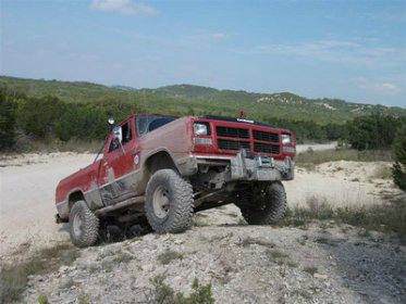

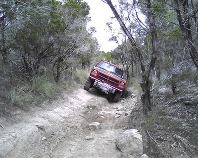

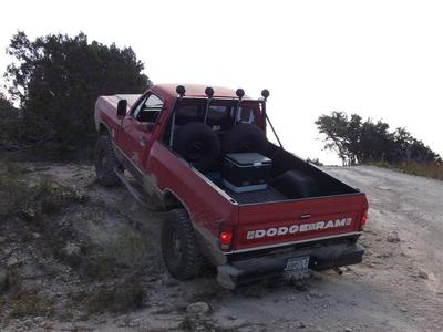

Thanks for the interest. I can't believe how fun this project has been. I've taken this truck in some unbelieveable places. I run some Cooper Discovery M/T 33's on 15x8 ProComp Rock Crawlers.
Since the original post, I've installed a PowerTrax locker and really like it and a 3" body lift. Some people say it's a waste of time to lift a 2x but I really like the way it looks and performs. I get lookie lou's all the time and thumbs up when I'm driving. Good enough for me. Here's some current pics of my last outing.
