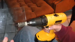

Default Update - How To Change Your Odometer
I finally figured out how to change my salvaged odometer to match the original that it replaced. As noted above, the new speedo had a trip odometer and the old one did not. It seems there are at least two ways to do this, the hard way and the easy way.
The hard way.
Remove the odometer from the speedometer unit. Make sure that the mileage is centered in the middle of the metal disks that are between each cylinder. Essentially, there will be a row of metal “spokes” above and below. Attach a drill chuck to the little metal tip next to the gear sprocket and run the drill in reverse. All the while stabilizing the metal “spokes”. I used a sheet of glass. Depending upon the speed you select, this changes the odometer about 6,000 miles in an hour.
The other way is kind of like doing a Rubik’s cube.
Pretend your mileage is "1 2 3 4 5 . 6". Hold the far left digit (1) and the one “spoke” to its right with your left hand. Keeping the digits to the right stabilized (2345.6) with their metal spokes, turn those cylinders and their spokes in unison in an upwardly direction, after an almost complete revolution, when the spoke/cylinder that is the furthest to the left (2) of the rotated ones catches, push it on through and you will feel it catch the non-rotated cylinder (1) and rotate it one digit. Keep doing this until the furthest to the left cylinder (1) is at the digit you want and then move one cylinder to the right and repeat this process.
With the drill...

Old Feb 3, 2012 | 10:32 PM
crazzywolfie's Avatar
crazzywolfie
Posts: 8,025
Likes: 72
From: orangeville ontario
i changed mine the second way you posted but i did not install mine immediately and forgot to add 50km so i will have to take mine apart again and update it and install it. i was setting mine up to reflect the amount of km i have put on the truck since i got it.
Old Feb 4, 2012 | 08:48 AM
pumbu's Avatar
pumbu
Joined: Oct 2011
Posts: 154
From: Falls Church, VA
Crazzywolfie, in retrospect, it is just tricking out the odometer by stabilizing the cylinders to the right of what you are trying to change.
