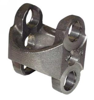

i can post a picture for you tommorrow about where to grind the double carden, i just spent months figuring out my front shaft. also there is a spacer available to go between the front transfer case and the shaft where the four bolts connect to help re engage your spines.

A picture would be awesome. I was looking at those slavers too. Thanks!

Basically you want to take the squarness down to nice and round.
