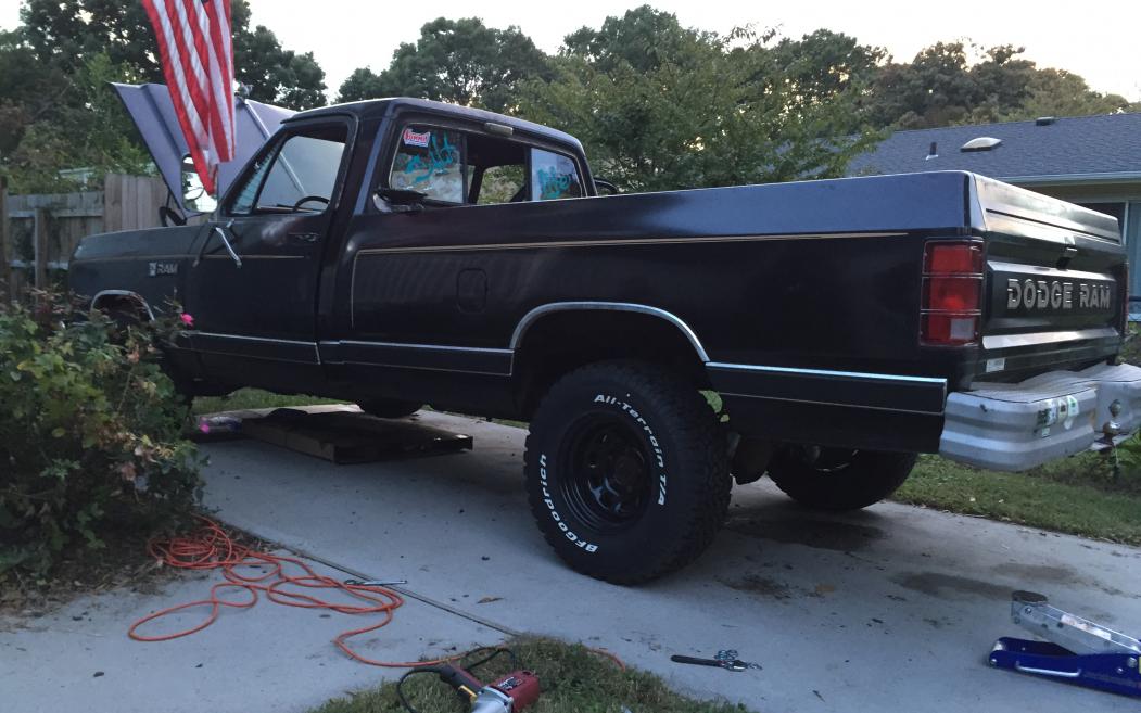

I have a D150 and did a super lift 2" leaf block kit with Rancho RS9000XL shocks in the rear (had to order a separate set of u-bolts as the kit is made for the 4wd that already has a stock leaf block) and coil spring spacers in the front. haven't decided which shocks to use as i am waiting for replacement ball joints because all mine are shot. here is a pic with the 2" rear done
