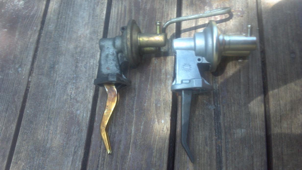

Just got a new fuel pump for my newly acquired Ram D150 5.2L V8. When i took the old one out, I noticed there were some marked differences between old and new.
Youll notice that the old one has a pronounces bend in the arm, and also a spring on the under side of it that is absent from the new one. Just wondering if this will be a problem, or if it is just a design change that is not going to effect the way it operates.

Slapped in on there and got the alternator back on there. Started right up without having to prime the carb. Havent driven it yet as I'm waiting for the liquid gasket to settle a little before getting the engine hot. Hopefully that fixes my hard starting problem.
i don't think the fuel pump should have anything to do with the truck having a hard time starting. there should be enough gas in the carb that if you pump the gas peddle twice it should fire right up. also when was the last time it had a tune up?

It would start as long as I gave it gas before. Now it just starts right up. Putting the coil in fixed my hesitation problems. This truck had been sitting in the dirt for years.
